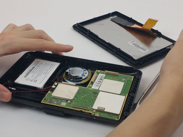

  3. Garmin Dezl 760LMT Motherboard Replacement: crwdns2935265:03crwdnd2935265:01crwdnd2935265:01crwdne2935265:0
    • Turn the device over, laying it on its back with the screen facing upwards.
    • Lift the front panel away from the silver part of the back panel.
    • Make sure not to rip the ribbon cable that is connected to the screen and the motherboard.
  4. Garmin Dezl 760LMT Motherboard Replacement, Screen Ribbon Cable: crwdns2935265:04crwdnd2935265:01crwdnd2935265:02crwdne2935265:0 Garmin Dezl 760LMT Motherboard Replacement, Screen Ribbon Cable: crwdns2935265:04crwdnd2935265:02crwdnd2935265:02crwdne2935265:0
    • Lift the screen opposite where the "GARMIN" logo is located. Remove the clear tape holding the ribbon cable to the motherboard.

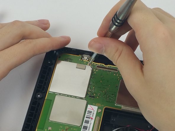

  6. Garmin Dezl 760LMT Motherboard Replacement, Motherboard: crwdns2935265:06crwdnd2935265:01crwdnd2935265:02crwdne2935265:0 Garmin Dezl 760LMT Motherboard Replacement, Motherboard: crwdns2935265:06crwdnd2935265:02crwdnd2935265:02crwdne2935265:0
    • Using a Torx T5 screwdriver, unscrew the six 5mm screws on the motherboard.

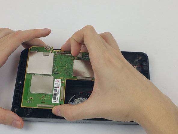

  7. Garmin Dezl 760LMT Motherboard Replacement: crwdns2935265:07crwdnd2935265:01crwdnd2935265:03crwdne2935265:0 Garmin Dezl 760LMT Motherboard Replacement: crwdns2935265:07crwdnd2935265:02crwdnd2935265:03crwdne2935265:0 Garmin Dezl 760LMT Motherboard Replacement: crwdns2935265:07crwdnd2935265:03crwdnd2935265:03crwdne2935265:0
    • Grasp each of the three wires near where it is attached to the motherboard. Lift them upward to detach them.
    • Lift the motherboard from the device.
