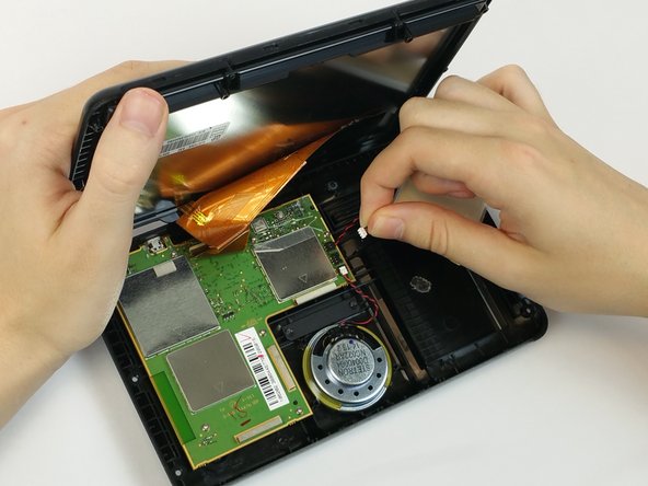

    • Using a Torx T6 Screwdriver, remove the ten 7mm screws from the back panel.
  2. Garmin Dezl 760LMT Battery Replacement: crwdns2935265:02crwdnd2935265:01crwdnd2935265:03crwdne2935265:0 Garmin Dezl 760LMT Battery Replacement: crwdns2935265:02crwdnd2935265:02crwdnd2935265:03crwdne2935265:0 Garmin Dezl 760LMT Battery Replacement: crwdns2935265:02crwdnd2935265:03crwdnd2935265:03crwdne2935265:0
    • Using a metal spudger, pry the device apart.
    • To recombine them, line up the two halves of the device and press them together.
  3. Garmin Dezl 760LMT Battery Replacement: crwdns2935265:03crwdnd2935265:01crwdnd2935265:01crwdne2935265:0
    • Turn the device over, laying it on its back with the screen facing upwards.
    • Lift the front panel away from the silver part of the back panel.
    • Make sure not to rip the ribbon cable that is connected to the screen and the motherboard.
  4. Garmin Dezl 760LMT Battery Replacement, Battery: crwdns2935265:04crwdnd2935265:01crwdnd2935265:02crwdne2935265:0 Garmin Dezl 760LMT Battery Replacement, Battery: crwdns2935265:04crwdnd2935265:02crwdnd2935265:02crwdne2935265:0
    • This photo shows the use of a tool that is not ESD safe. Use a nylon spudger to complete this step.
    • Use a nylon spudger to pry the battery from the device.
    • During reassembly, place double-sided electrical tape under the battery before pressing it into its slot.
  5. Garmin Dezl 760LMT Battery Replacement: crwdns2935265:05crwdnd2935265:01crwdnd2935265:02crwdne2935265:0 Garmin Dezl 760LMT Battery Replacement: crwdns2935265:05crwdnd2935265:02crwdnd2935265:02crwdne2935265:0
    • Grasp the battery wire near the motherboard and lift upward to detach the connector.

Completely useless as soon as you open the cover the old ribbon rips and you garmin is junk. Don’t waste your money
Pissedoff - crwdns2934203:0crwdne2934203:0
you have to be more careful with your stuff dude..
Bealphares Voluptarius -
Thanks for the tutorial, it was very helpfull. I've changed the battery without any problem. Good job
