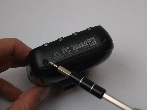

  4. Garmin Dash Cam 20 Screen Replacement: crwdns2935265:04crwdnd2935265:01crwdnd2935265:02crwdne2935265:0 Garmin Dash Cam 20 Screen Replacement: crwdns2935265:04crwdnd2935265:02crwdnd2935265:02crwdne2935265:0
    • Rotate the Dash Cam to where the product information faces you.
    • Remove the two 5 mm screws using the Torx T5 screwdriver.

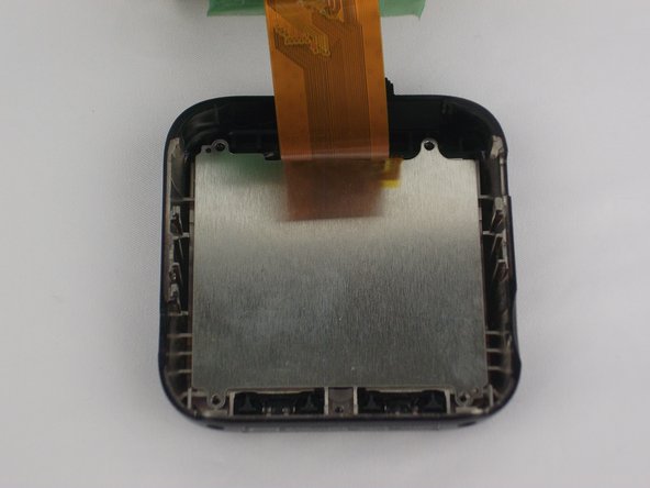

  8. Garmin Dash Cam 20 Screen Replacement: crwdns2935265:08crwdnd2935265:01crwdnd2935265:02crwdne2935265:0 Garmin Dash Cam 20 Screen Replacement: crwdns2935265:08crwdnd2935265:02crwdnd2935265:02crwdne2935265:0
    • Use the metal spudger to remove metal plate from device. This will reveal the screen.
  9. Garmin Dash Cam 20 Screen Replacement: crwdns2935265:09crwdnd2935265:01crwdnd2935265:03crwdne2935265:0 Garmin Dash Cam 20 Screen Replacement: crwdns2935265:09crwdnd2935265:02crwdnd2935265:03crwdne2935265:0 Garmin Dash Cam 20 Screen Replacement: crwdns2935265:09crwdnd2935265:03crwdnd2935265:03crwdne2935265:0
    • Use the metal spudger to remove screen from device.
  10. Garmin Dash Cam 20 Screen Replacement: crwdns2935265:010crwdnd2935265:01crwdnd2935265:01crwdne2935265:0
    • The screen is now detached.
