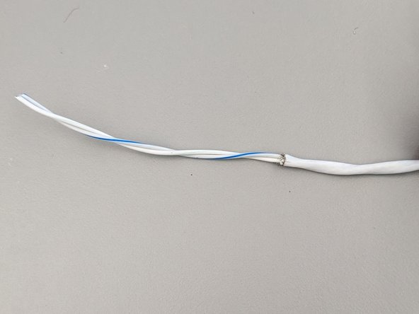

  4. Garmin Avionics Wiring Termination, Strip wire: crwdns2935265:04crwdnd2935265:01crwdnd2935265:02crwdne2935265:0 Garmin Avionics Wiring Termination, Strip wire: crwdns2935265:04crwdnd2935265:02crwdnd2935265:02crwdne2935265:0
    • Expose about 1.5" of shield by removing outer layer of wire.
  5. Garmin Avionics Wiring Termination, Remove shielding: crwdns2935265:05crwdnd2935265:01crwdnd2935265:02crwdne2935265:0 Garmin Avionics Wiring Termination, Remove shielding: crwdns2935265:05crwdnd2935265:02crwdnd2935265:02crwdne2935265:0
    • Remove shielding to expose wires
    • Option 1: unbraid shield and the cut away from wire
    • Option 2: carefully cut shield away without nicking the interior wires
  6. Garmin Avionics Wiring Termination, Cut a shield block: crwdns2935265:06crwdnd2935265:01crwdnd2935265:01crwdne2935265:0
    • Cut a 0.25" long section from outer layer of the wire about 2.5" from the end of the wire.
    • This accomplished with a razor. A new razor will cut more easily through the insulation but can also cut through the shielding. A dull razor is harder to cut with but also more forgiving to mistakes.
    • If the shielding is cut through and the interior wires nicked there is a high potential for a short to ground and that section of wire must be cut off and the wire must be restarted.

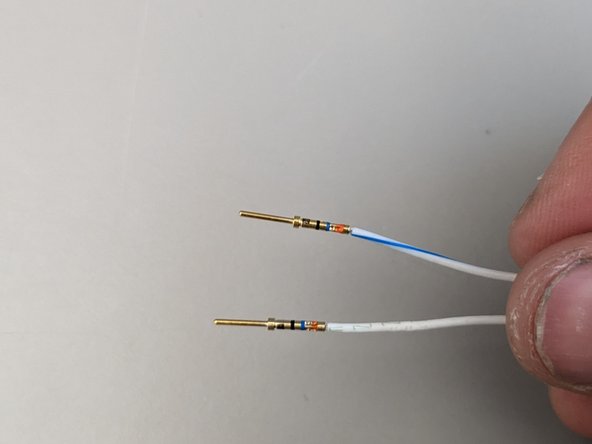

  8. Garmin Avionics Wiring Termination, Wire termination: crwdns2935265:08crwdnd2935265:01crwdnd2935265:02crwdne2935265:0 Garmin Avionics Wiring Termination, Wire termination: crwdns2935265:08crwdnd2935265:02crwdnd2935265:02crwdne2935265:0
    • Strip wires appropriate length - detailed in next step
    • Crimp terminals to wire
  9. Garmin Avionics Wiring Termination, Wire strip length: crwdns2935265:09crwdnd2935265:01crwdnd2935265:03crwdne2935265:0 Garmin Avionics Wiring Termination, Wire strip length: crwdns2935265:09crwdnd2935265:02crwdnd2935265:03crwdne2935265:0 Garmin Avionics Wiring Termination, Wire strip length: crwdns2935265:09crwdnd2935265:03crwdnd2935265:03crwdne2935265:0
    • The wire strip length should by just barely longer than the barrel (where the wire goes) of the crimped contact
    • First picture shows a correct termination
    • Second picture shows to long of strip on wire
    • To make sure the wire is stripped long enough the conductor strands should be visible in the witness hole circled in the third picture
