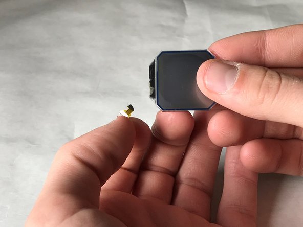

  9. Garmin Approach S2 Motherboard Replacement: crwdns2935265:09crwdnd2935265:01crwdnd2935265:01crwdne2935265:0
    • Remove the screen from the motherboard.
    • Notice our tape retaining the connector to the screen. This is so easy to rip!
