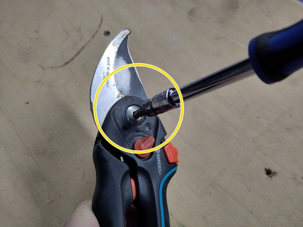

  1. Gardena BS-XL Spring Replacement, disconnect the blades: crwdns2935265:01crwdnd2935265:01crwdnd2935265:01crwdne2935265:0
    • The bolt holding the 2 blades together is typically fastened with threadlocker from the factory to prevent the bolt from undoing itself when in use.
    • While holding the shears in a vise, undo the T30 bolt holding the 2 blades together.

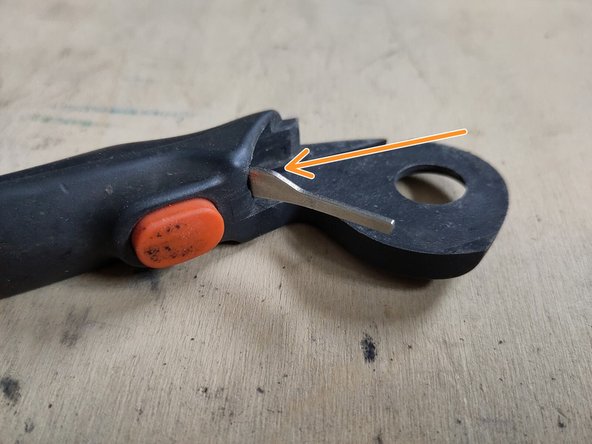

  2. Gardena BS-XL Spring Replacement, remove the broken spring: crwdns2935265:02crwdnd2935265:01crwdnd2935265:03crwdne2935265:0 Gardena BS-XL Spring Replacement, remove the broken spring: crwdns2935265:02crwdnd2935265:02crwdnd2935265:03crwdne2935265:0 Gardena BS-XL Spring Replacement, remove the broken spring: crwdns2935265:02crwdnd2935265:03crwdnd2935265:03crwdne2935265:0
    • This step assumes the spring is broken in the middle.
    • Remove the first part of the broken spring from the handle.
    • Pull the blade from the handle.
    • Remove the second part of the broken spring from the handle. If it is stuck, you can use a flathead screwdriver to wriggle it loose.

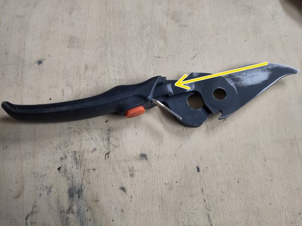

  3. Gardena BS-XL Spring Replacement, insert the new spring: crwdns2935265:03crwdnd2935265:01crwdnd2935265:03crwdne2935265:0 Gardena BS-XL Spring Replacement, insert the new spring: crwdns2935265:03crwdnd2935265:02crwdnd2935265:03crwdne2935265:0 Gardena BS-XL Spring Replacement, insert the new spring: crwdns2935265:03crwdnd2935265:03crwdnd2935265:03crwdne2935265:0
    • Slide the new spring into the handle, and make sure there is room for the blade behind it.
    • Slide it in as far as it will go.
    • Push the blade back in until the handle hole aligns with the blade hole. This will put tension on the spring.

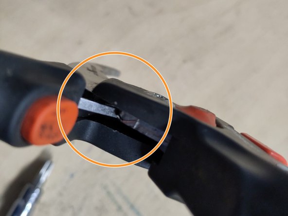

  4. Gardena BS-XL Spring Replacement, connect blades: crwdns2935265:04crwdnd2935265:01crwdnd2935265:03crwdne2935265:0 Gardena BS-XL Spring Replacement, connect blades: crwdns2935265:04crwdnd2935265:02crwdnd2935265:03crwdne2935265:0 Gardena BS-XL Spring Replacement, connect blades: crwdns2935265:04crwdnd2935265:03crwdnd2935265:03crwdne2935265:0
    • Apply some threadlock on the bolt.
    • Align both blades and insert the nut. Screw in the bolt partially.
    • Ensure the spring is level and pushing against the other blade.
    • Fasten the bolt while opening and closing the shears to make sure it is neither to loose or too tight, and also to verify the spring is working correctly.
