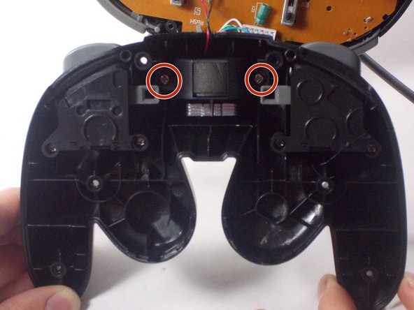

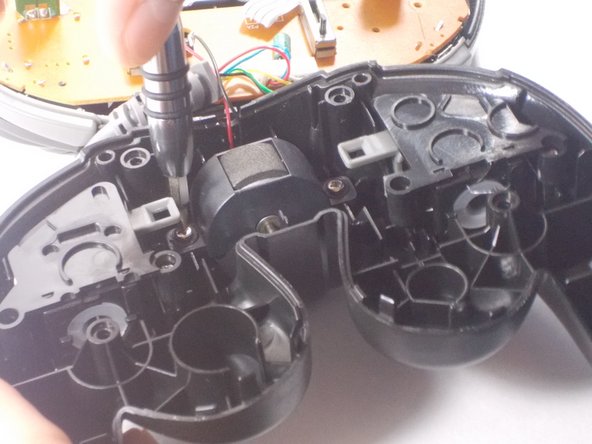

    • After separation, locate the rumble motor that is attached to the bottom cover of the controller.
    • Loosen and remove the 2 screws that are holding the rumble motor in place.
    • Lift and remove the rumble motor from the case.

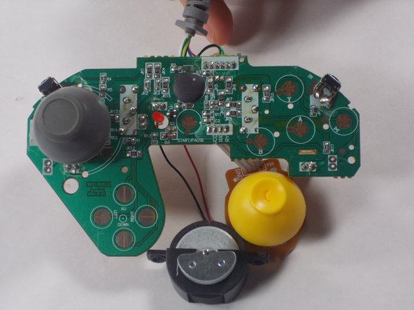

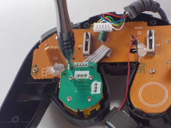

    • On the top cover of the controller, locate the green portion of the motherboard.
    • Loosen and remove the 1 screw in the upper left side of the green motherboard.

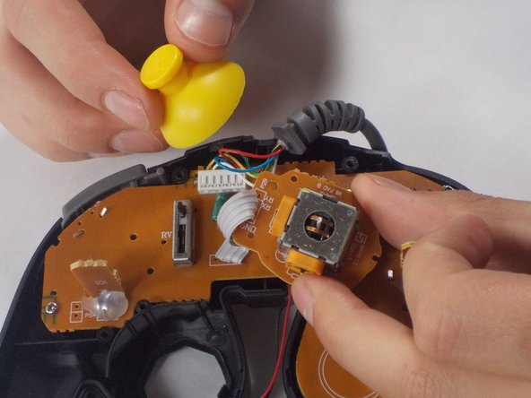

    • Turn the green motherboard over and attached to the motherboard will be the yellow c-stick.
    • Firmly, but carefully, pull the c-stick off, and clean around the area before reattaching or replacing the c-stick.
    • After cleaning or replacing the c-stick, reattach the green motherboard piece to the orange motherboard piece.

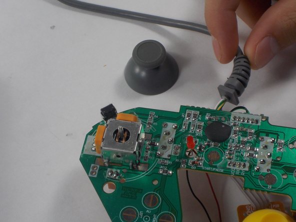

    • Locate the gray joystick that is attached to the left side of the motherboard.
    • Similarly to the yellow c-stick, firmly, but carefully, pull the gray joystick off, and clean around the area before reattaching or replacing the joystick.
