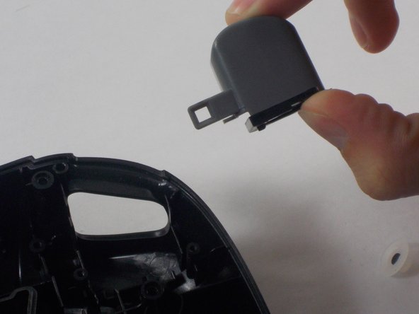

    • Now that the back panel has been removed it should be easy to snap off the "Z" and "TURBO" buttons as shown in the images.

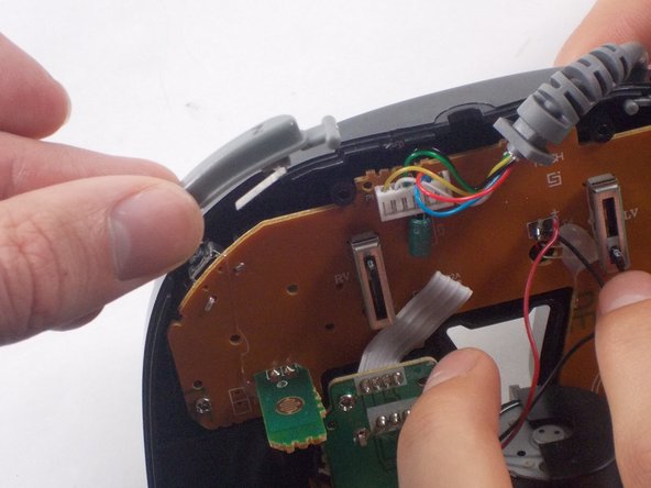

    • Remove the two screws on the motherboard so that you can remove the motherboard from the front cover.
