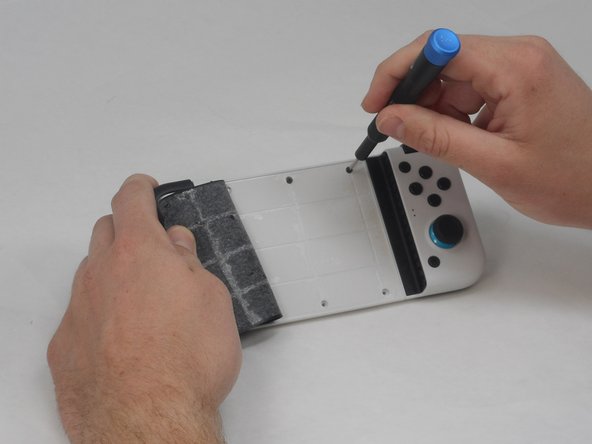

  2. GameSir X2 Type-C Left Trigger Replacement: crwdns2935265:02crwdnd2935265:01crwdnd2935265:02crwdne2935265:0 GameSir X2 Type-C Left Trigger Replacement: crwdns2935265:02crwdnd2935265:02crwdnd2935265:02crwdne2935265:0
    • Remove the eight 6 mm T6 Torx screws.

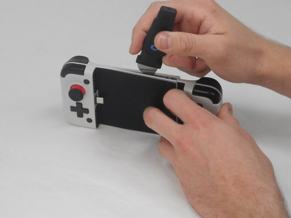

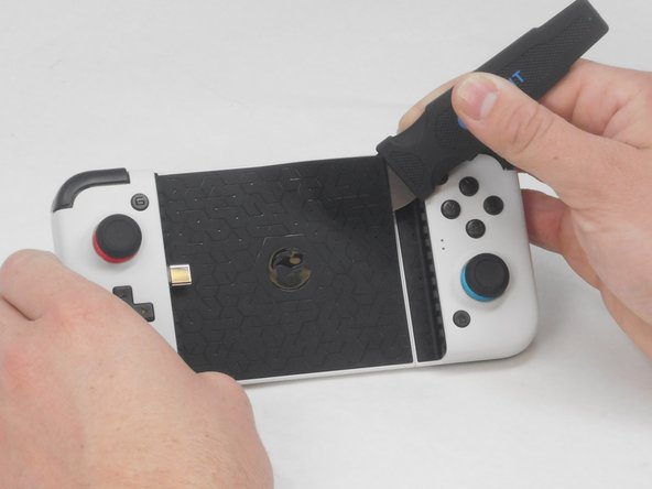

  3. GameSir X2 Type-C Left Trigger Replacement: crwdns2935265:03crwdnd2935265:01crwdnd2935265:01crwdne2935265:0
    • Use a straight edge to remove the rubber pad on the front of the device.

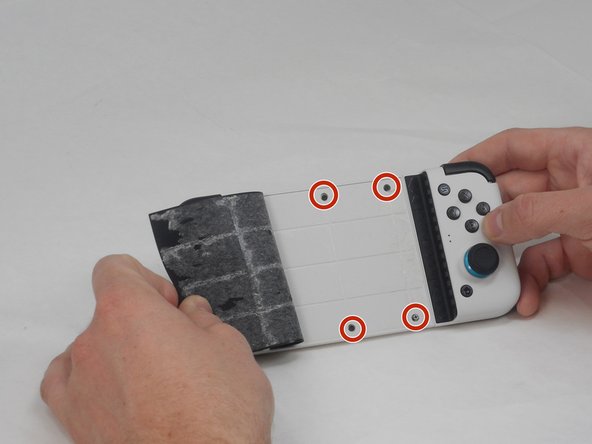

  4. GameSir X2 Type-C Left Trigger Replacement: crwdns2935265:04crwdnd2935265:01crwdnd2935265:02crwdne2935265:0 GameSir X2 Type-C Left Trigger Replacement: crwdns2935265:04crwdnd2935265:02crwdnd2935265:02crwdne2935265:0
    • Remove the four 4.5 mm screws with a Phillips #000 screwdriver.

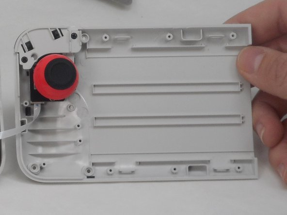

  5. GameSir X2 Type-C Left Trigger Replacement: crwdns2935265:05crwdnd2935265:01crwdnd2935265:02crwdne2935265:0 GameSir X2 Type-C Left Trigger Replacement: crwdns2935265:05crwdnd2935265:02crwdnd2935265:02crwdne2935265:0
    • Use a straight edge to pry open the controller, following the seam on the controller.
    • Some force is necessary, but be careful not to damage any of the clips holding the controller together.

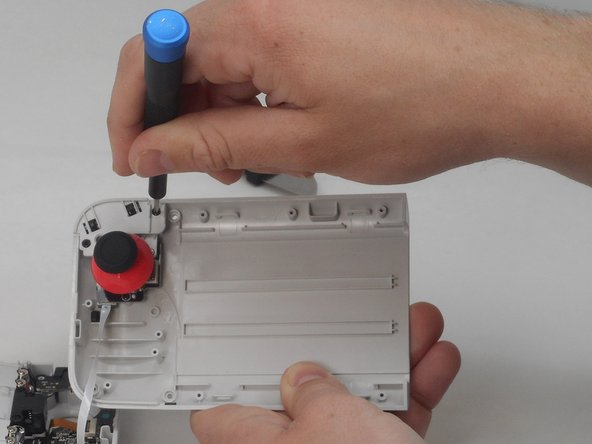

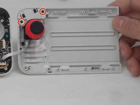

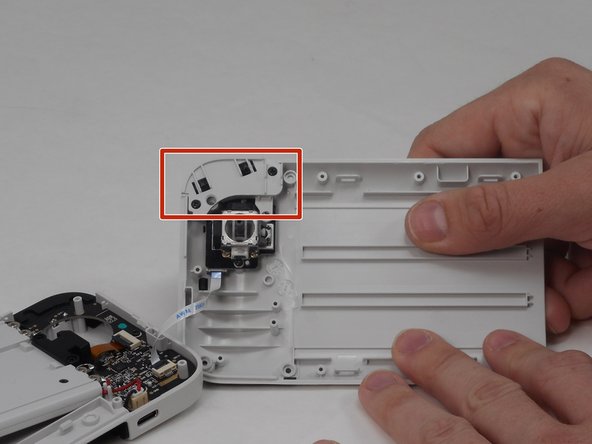

  6. GameSir X2 Type-C Left Trigger Replacement, Left Trigger: crwdns2935265:06crwdnd2935265:01crwdnd2935265:02crwdne2935265:0 GameSir X2 Type-C Left Trigger Replacement, Left Trigger: crwdns2935265:06crwdnd2935265:02crwdnd2935265:02crwdne2935265:0
    • Remove the two 6mm screws that secure the trigger assembly with a Phillips #000 screwdriver.

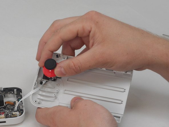

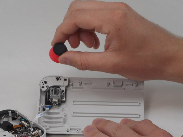

  7. GameSir X2 Type-C Left Trigger Replacement: crwdns2935265:07crwdnd2935265:01crwdnd2935265:02crwdne2935265:0 GameSir X2 Type-C Left Trigger Replacement: crwdns2935265:07crwdnd2935265:02crwdnd2935265:02crwdne2935265:0
    • Remove the joystick cover.

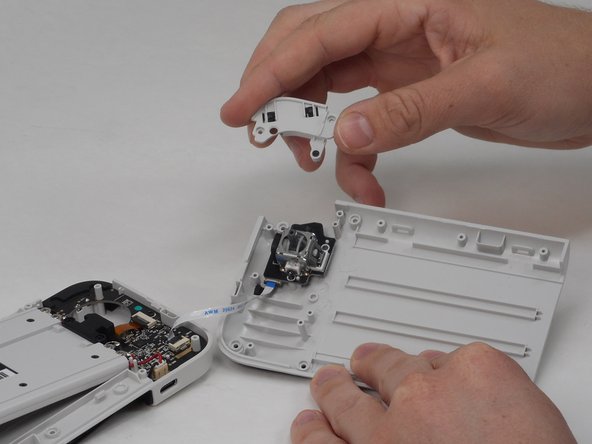

  8. GameSir X2 Type-C Left Trigger Replacement: crwdns2935265:08crwdnd2935265:01crwdnd2935265:02crwdne2935265:0 GameSir X2 Type-C Left Trigger Replacement: crwdns2935265:08crwdnd2935265:02crwdnd2935265:02crwdne2935265:0
    • Lift the trigger assembly away from the device.
