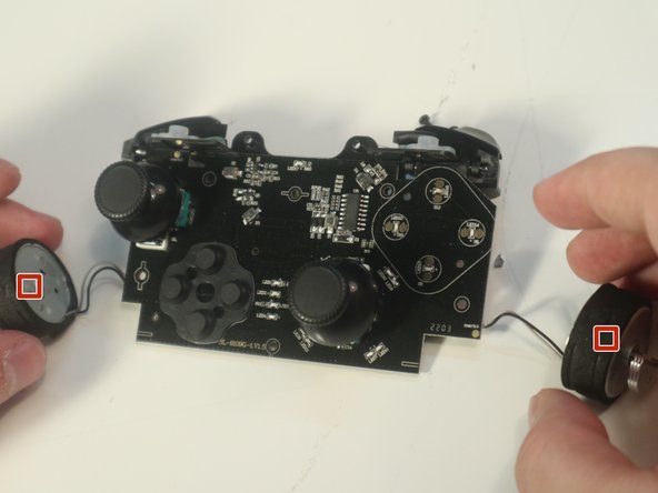

  5. GameSir T4 Pro Joystick Replacement, Joystick: crwdns2935265:05crwdnd2935265:01crwdnd2935265:02crwdne2935265:0 GameSir T4 Pro Joystick Replacement, Joystick: crwdns2935265:05crwdnd2935265:02crwdnd2935265:02crwdne2935265:0
    • Disconnect the rumblers from the motherboard
    • Be careful not to pull the wires while disconnecting rumbler

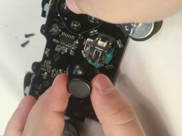

  7. GameSir T4 Pro Joystick Replacement: crwdns2935265:07crwdnd2935265:01crwdnd2935265:02crwdne2935265:0 GameSir T4 Pro Joystick Replacement: crwdns2935265:07crwdnd2935265:02crwdnd2935265:02crwdne2935265:0
    • Using the wedge tool, pop the joystick out

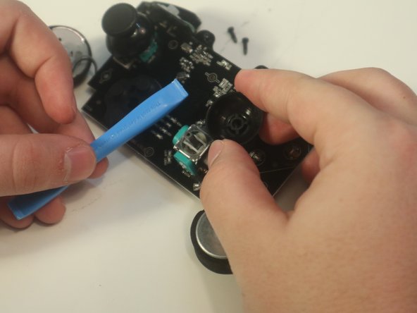

  8. GameSir T4 Pro Joystick Replacement: crwdns2935265:08crwdnd2935265:01crwdnd2935265:02crwdne2935265:0 GameSir T4 Pro Joystick Replacement: crwdns2935265:08crwdnd2935265:02crwdnd2935265:02crwdne2935265:0
    • Make sure the square of the joystick matches the square of the pad and pop it in place.

I bought ps4 joysticks for the repair, but ps4 joysticks seems larger so it's stuck
Mohamed NACERI - crwdns2934203:0crwdne2934203:0
PlayStation4 stick is not compatible with GameSir T4 Pro. The stick for the Nintendo Switch PRO controller does not interfere, but this also requires processing for installation.
NAKIRI - crwdns2934203:0crwdne2934203:0
It appears that you will need to remove the light diffuser(white tubular plastic sleeve) from the case to make the parts fit.
NAKIRI -
Los stick del control de ps4 no son compatibles no entiendo por qué está esta quia de reparación si es falsa compre los stick de ps4 y no fueron compatibles tuve que modificar el control con un dremel muy delicadamente, ya que los stick de ps4 son ligeramente mas anchos y se atascan al girar se tiene que comer la carcasa del mando unos 2mm en cada agujero donde van los stick asi que no sigan las recomendaciones de esta guia al menos que tengan pensado modificar su control
