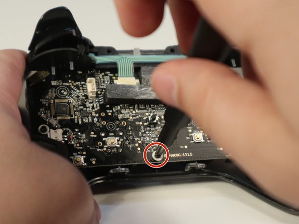

  5. GameSir T4 Pro Directional Pad Replacement, Directional Pad: crwdns2935265:05crwdnd2935265:01crwdnd2935265:02crwdne2935265:0 GameSir T4 Pro Directional Pad Replacement, Directional Pad: crwdns2935265:05crwdnd2935265:02crwdnd2935265:02crwdne2935265:0
    • To get to the directional pad (d-pad), remove the three 5mm screws on the motherboard.
  6. GameSir T4 Pro Directional Pad Replacement: crwdns2935265:06crwdnd2935265:01crwdnd2935265:01crwdne2935265:0
    • Disconnect all white connectors from the motherboard.
  7. GameSir T4 Pro Directional Pad Replacement: crwdns2935265:07crwdnd2935265:01crwdnd2935265:01crwdne2935265:0
    • Carefully pull the motherboard away to reveal the front panel.
  8. GameSir T4 Pro Directional Pad Replacement: crwdns2935265:08crwdnd2935265:01crwdnd2935265:01crwdne2935265:0
    • Remove the d-pad from the front panel.
  9. GameSir T4 Pro Directional Pad Replacement: crwdns2935265:09crwdnd2935265:01crwdnd2935265:01crwdne2935265:0
    • Place your new d-pad in place.
