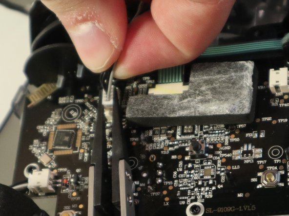

  5. GameSir T4 Pro Charging Port Replacement, Charging Port: crwdns2935265:05crwdnd2935265:01crwdnd2935265:02crwdne2935265:0 GameSir T4 Pro Charging Port Replacement, Charging Port: crwdns2935265:05crwdnd2935265:02crwdnd2935265:02crwdne2935265:0
    • Use the needle nose pliers to remove the plastic connection from the motherboard.
    • You may hold the wires for stability, but do not tug on the wires.

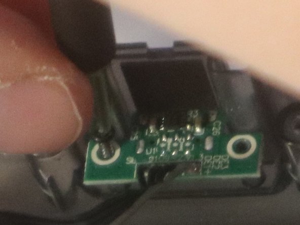

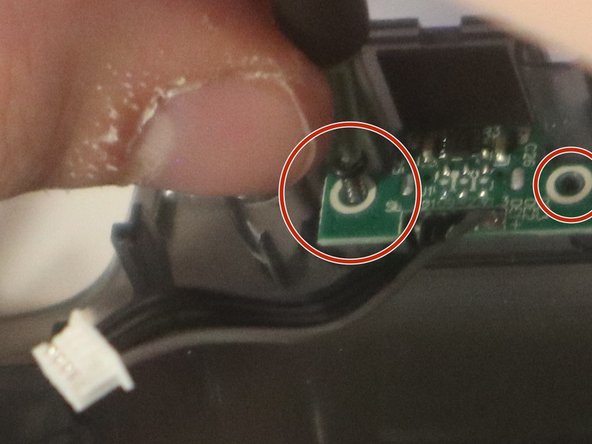

  6. GameSir T4 Pro Charging Port Replacement: crwdns2935265:06crwdnd2935265:01crwdnd2935265:02crwdne2935265:0 GameSir T4 Pro Charging Port Replacement: crwdns2935265:06crwdnd2935265:02crwdnd2935265:02crwdne2935265:0
    • Remove the two 5mm screws on the charging port and take out the old charging port.
  7. GameSir T4 Pro Charging Port Replacement: crwdns2935265:07crwdnd2935265:01crwdnd2935265:02crwdne2935265:0 GameSir T4 Pro Charging Port Replacement: crwdns2935265:07crwdnd2935265:02crwdnd2935265:02crwdne2935265:0
    • Put your new compatible charging port in place.
    • Make sure to screw in the 5mm screws into your new charing port
