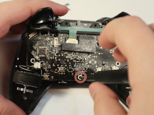

    • Remove the three 5mm screws on the motherboard.
  6. GameSir T4 Pro Action Buttons Replacement: crwdns2935265:06crwdnd2935265:01crwdnd2935265:01crwdne2935265:0
    • Disconnect all white connectors from the motherboard.
  7. GameSir T4 Pro Action Buttons Replacement: crwdns2935265:07crwdnd2935265:01crwdnd2935265:01crwdne2935265:0
    • Carefully pull the motherboard away to reveal the front panel.

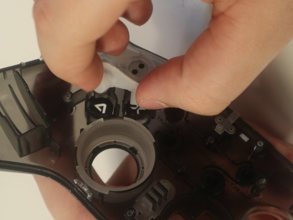

  8. GameSir T4 Pro Action Buttons Replacement: crwdns2935265:08crwdnd2935265:01crwdnd2935265:02crwdne2935265:0 GameSir T4 Pro Action Buttons Replacement: crwdns2935265:08crwdnd2935265:02crwdnd2935265:02crwdne2935265:0
    • Remove the white rubber panel to get access to the buttons.
    • Put a small dab of isopropyl alcohol on a cotton swab, and clean around the area of your sticky button.
