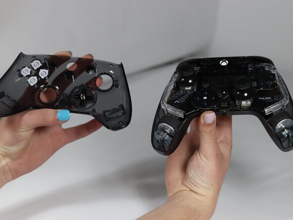

  2. GameSir K1 Kaleid Rumblepad Replacement: crwdns2935265:02crwdnd2935265:01crwdnd2935265:03crwdne2935265:0 GameSir K1 Kaleid Rumblepad Replacement: crwdns2935265:02crwdnd2935265:02crwdnd2935265:03crwdne2935265:0 GameSir K1 Kaleid Rumblepad Replacement: crwdns2935265:02crwdnd2935265:03crwdnd2935265:03crwdne2935265:0

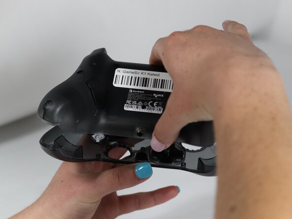

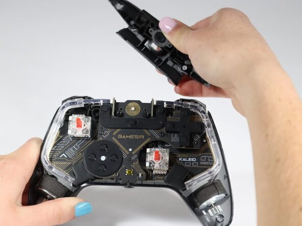

    • Hold the controller between your hands, with the front panel facing down.
    • Lift the back panel.
    • It should come up easily. If met with resistance, check for a missed screw on the back panel.

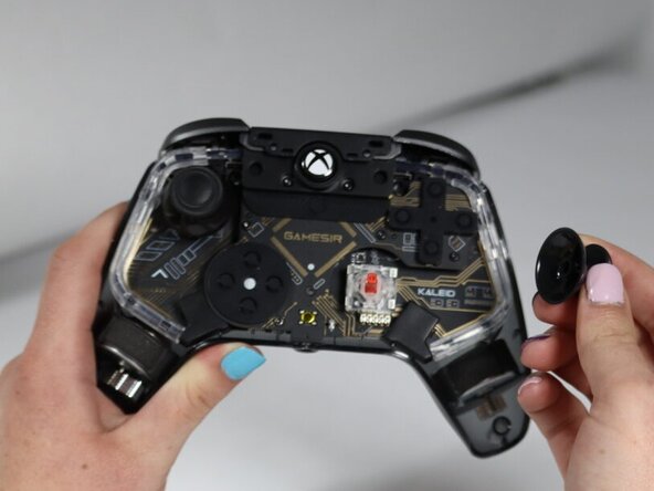

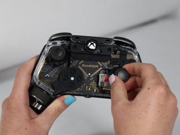

    • Hold the controller, grasp the rubber joystick cover, and pull upwards.
    • There will be resistance; pull firmly.
    • Repeat for the second joystick cover.

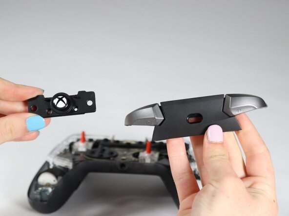

    • Remove the power button and bumpers.

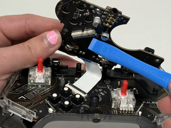

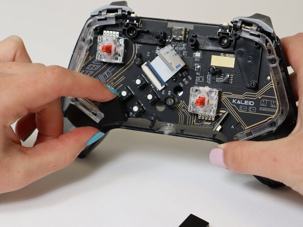

    • Gently pull the daughterboard up from the front center and open it like a hinge to the left exposing the ribbon.
    • Use the iFixit opening tool or tweezers to lift the black clamp holding the ribbon in. Align the iFixit opening tool with the ribbon, gently push under the clamp, and then pop it upwards.
    • The ribbon can be removed from either the daughterboard or the motherboard below.
    • Replace this daughterboard to fix the D-pad function.

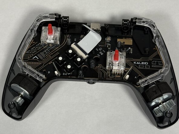

  8. GameSir K1 Kaleid Rumblepad Replacement, Motherboard: crwdns2935265:08crwdnd2935265:01crwdnd2935265:03crwdne2935265:0 GameSir K1 Kaleid Rumblepad Replacement, Motherboard: crwdns2935265:08crwdnd2935265:02crwdnd2935265:03crwdne2935265:0 GameSir K1 Kaleid Rumblepad Replacement, Motherboard: crwdns2935265:08crwdnd2935265:03crwdnd2935265:03crwdne2935265:0
    • Using your fingers, gently grab the top of one of the silicone LED strips and begin to remove it from the plastic holders to expose the screws below.
    • The LED strip can gently be removed along with the black end coverings located at the bottom.
    • Use the spudger or fingers to gently pry off the end coverings.
  9. GameSir K1 Kaleid Rumblepad Replacement: crwdns2935265:09crwdnd2935265:01crwdnd2935265:01crwdne2935265:0

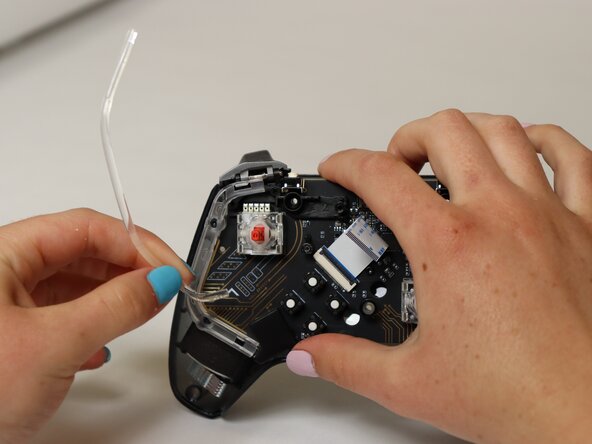

    • Remove five screws, which will release the clear runners. Set both the screws and runners aside.
  10. GameSir K1 Kaleid Rumblepad Replacement: crwdns2935265:010crwdnd2935265:01crwdnd2935265:03crwdne2935265:0 GameSir K1 Kaleid Rumblepad Replacement: crwdns2935265:010crwdnd2935265:02crwdnd2935265:03crwdne2935265:0 GameSir K1 Kaleid Rumblepad Replacement: crwdns2935265:010crwdnd2935265:03crwdnd2935265:03crwdne2935265:0

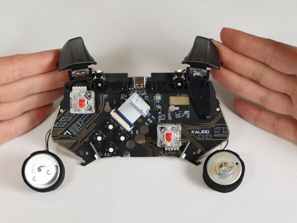

    • Insert the opening tool through the center, between the motherboard and shell, and lift. This will raise the motherboard off the pegs.
    • The motherboard will get stuck on the pegs unless lifted out levelly from the shell.
    • Once the board is raised above the edge of the controller shell, use your fingers to pull the rest of the way.
    • Replace the motherboard to get the joysticks working again.

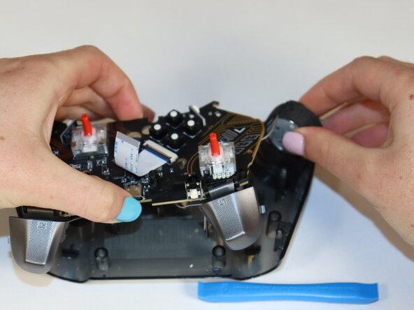

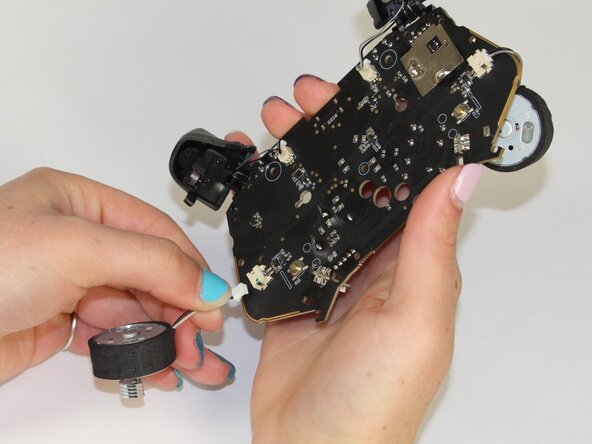

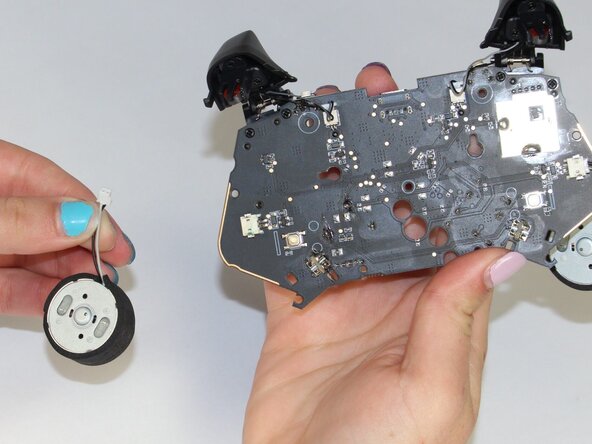

  11. GameSir K1 Kaleid Rumblepad Replacement, Rumblepad: crwdns2935265:011crwdnd2935265:01crwdnd2935265:03crwdne2935265:0 GameSir K1 Kaleid Rumblepad Replacement, Rumblepad: crwdns2935265:011crwdnd2935265:02crwdnd2935265:03crwdne2935265:0 GameSir K1 Kaleid Rumblepad Replacement, Rumblepad: crwdns2935265:011crwdnd2935265:03crwdnd2935265:03crwdne2935265:0
    • Gently pinch the wires right below the white connector.
    • Place your thumbnail on the wires near the top of the white plastic connector to minimize stress on the hardware.
    • The rumblepad will disconnect with little force. Repeat on the other side to replace both rumblepads.
