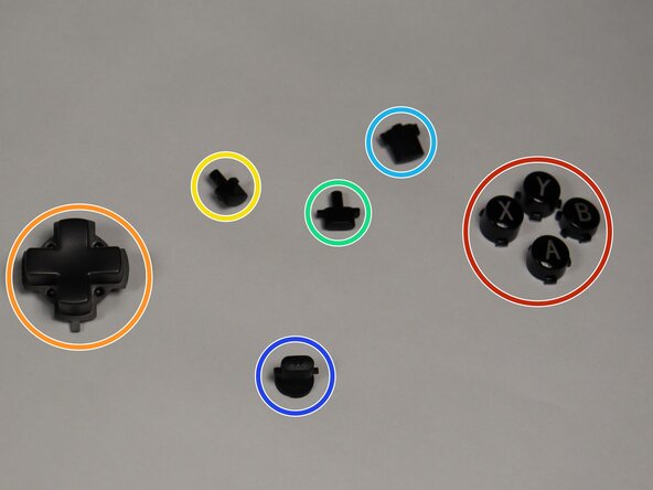

  3. GameSir K1 Kaleid Button Covers Replacement, Button Covers: crwdns2935265:03crwdnd2935265:01crwdnd2935265:02crwdne2935265:0 GameSir K1 Kaleid Button Covers Replacement, Button Covers: crwdns2935265:03crwdnd2935265:02crwdnd2935265:02crwdne2935265:0
    • Replace needed buttons.
    • Order matters: the buttons have different notches. Going clockwise: Y is at the top, B is to the right, A is bottom, and X is left.
    • A, B, X, Y Buttons.
    • The D-pad
    • The view button
    • The share button
    • The menu button
    • The M button
