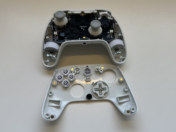

  3. GameSir G7 SE Joystick Module Replacement: crwdns2935265:03crwdnd2935265:01crwdnd2935265:02crwdne2935265:0 GameSir G7 SE Joystick Module Replacement: crwdns2935265:03crwdnd2935265:02crwdnd2935265:02crwdne2935265:0
    • Using a plastic spudger tool, remove the interior face plate. Go around all the edges, prying downwards until it's removed.
    • Make sure to hold the controller upside down; otherwise the buttons will fall out.
