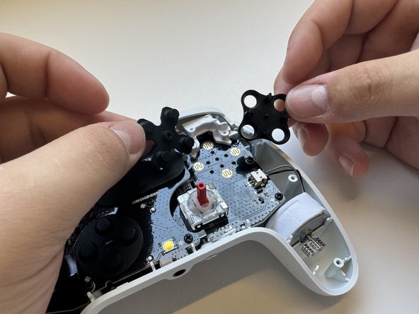

GameSir G7 SE Button Gaskets Replacement
  1. GameSir G7 SE Button Gaskets Replacement, Interior face plate: crwdns2935265:01crwdnd2935265:01crwdnd2935265:01crwdne2935265:0
    • Remove the faceplate by prying upwards with a plastic opening tool.
    • This faceplate is magnetic and will be easy to come off.
  2. GameSir G7 SE Button Gaskets Replacement: crwdns2935265:02crwdnd2935265:01crwdnd2935265:02crwdne2935265:0 GameSir G7 SE Button Gaskets Replacement: crwdns2935265:02crwdnd2935265:02crwdnd2935265:02crwdne2935265:0
    • Use a T6 Torx Screwdriver to remove the six 9 mm screws from the interior face plate.
  3. GameSir G7 SE Button Gaskets Replacement: crwdns2935265:03crwdnd2935265:01crwdnd2935265:02crwdne2935265:0 GameSir G7 SE Button Gaskets Replacement: crwdns2935265:03crwdnd2935265:02crwdnd2935265:02crwdne2935265:0
    • Using a plastic spudger tool, remove the interior face plate. Go around all the edges, prying downwards until it's removed.
    • Make sure to hold the controller upside down; otherwise the buttons will fall out.
  4. GameSir G7 SE Button Gaskets Replacement, Button Gaskets: crwdns2935265:04crwdnd2935265:01crwdnd2935265:01crwdne2935265:0
    • Pull up on the conductive rubber button gaskets to remove them.
    • Additionally, clean contacts with 91% isopropyl alcohol if needed.
  5. GameSir G7 SE Button Gaskets Replacement: crwdns2935265:05crwdnd2935265:01crwdnd2935265:02crwdne2935265:0 GameSir G7 SE Button Gaskets Replacement: crwdns2935265:05crwdnd2935265:02crwdnd2935265:02crwdne2935265:0
    • Make sure that the longer prongs on the button shroud/guide are facing you when reassembling.
