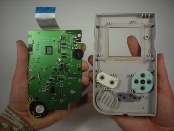

    1. Game Boy Speaker Replacement, Speaker: crwdns2935265:08crwdnd2935265:01crwdnd2935265:01crwdne2935265:0
      • Remove the 10 Phillips #00 screws from the motherboard.
    2. Game Boy Speaker Replacement: crwdns2935265:09crwdnd2935265:01crwdnd2935265:02crwdne2935265:0 Game Boy Speaker Replacement: crwdns2935265:09crwdnd2935265:02crwdnd2935265:02crwdne2935265:0
      • Use a plastic opening tool to gently lift the motherboard up and remove it from the front plastic case.
      • Use caution when lifting the board since the speaker is attached.
    3. Game Boy Speaker Replacement: crwdns2935265:010crwdnd2935265:01crwdnd2935265:03crwdne2935265:0 Game Boy Speaker Replacement: crwdns2935265:010crwdnd2935265:02crwdnd2935265:03crwdne2935265:0 Game Boy Speaker Replacement: crwdns2935265:010crwdnd2935265:03crwdnd2935265:03crwdne2935265:0
      • Desolder the two wires connecting the speaker to the motherboard.
      • Remove the speaker.
      • If you're new to soldering, refer to this guide for tips that will help with desoldering the speaker wires and/or soldering the new ones in place.
