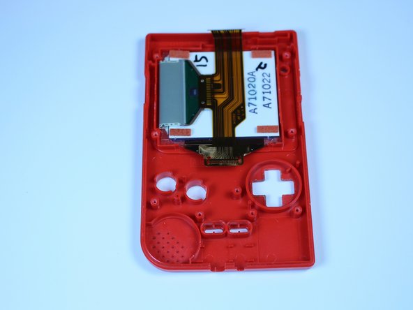

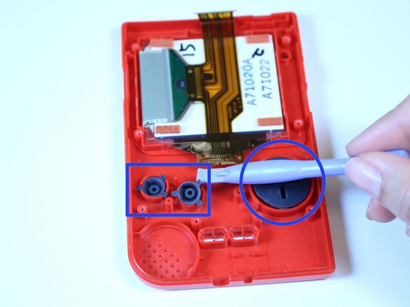

  7. Game Boy Pocket Buttons Replacement: crwdns2935265:07crwdnd2935265:01crwdnd2935265:03crwdne2935265:0 Game Boy Pocket Buttons Replacement: crwdns2935265:07crwdnd2935265:02crwdnd2935265:03crwdne2935265:0 Game Boy Pocket Buttons Replacement: crwdns2935265:07crwdnd2935265:03crwdnd2935265:03crwdne2935265:0
    • Use your fingers to remove the three silicone button covers.
    • Use a plastic opening tool to remove the buttons.
