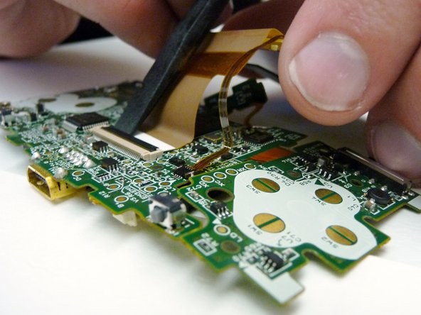

  17. Game Boy Micro LCD Screen Replacement, Motherboard: crwdns2935265:017crwdnd2935265:01crwdnd2935265:03crwdne2935265:0 Game Boy Micro LCD Screen Replacement, Motherboard: crwdns2935265:017crwdnd2935265:02crwdnd2935265:03crwdne2935265:0 Game Boy Micro LCD Screen Replacement, Motherboard: crwdns2935265:017crwdnd2935265:03crwdnd2935265:03crwdne2935265:0
    • The LCD screen is connected to the motherboard by two ribbon cables.
    • Use a plastic spudger to disconnect the LCD's ZIF connector.
  18. Game Boy Micro LCD Screen Replacement: crwdns2935265:018crwdnd2935265:01crwdnd2935265:03crwdne2935265:0 Game Boy Micro LCD Screen Replacement: crwdns2935265:018crwdnd2935265:02crwdnd2935265:03crwdne2935265:0 Game Boy Micro LCD Screen Replacement: crwdns2935265:018crwdnd2935265:03crwdnd2935265:03crwdne2935265:0
    • Use the tip of the spudger to lift the small, black tab holding the thin ribbon.
    • With both tabs lifted, pull the ribbons off the motherboard and remove the LCD screen.

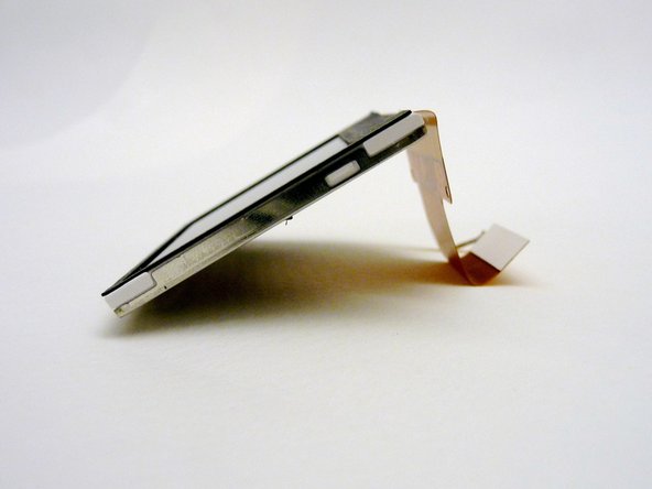

  19. Game Boy Micro LCD Screen Replacement, LCD Screen: crwdns2935265:019crwdnd2935265:01crwdnd2935265:02crwdne2935265:0 Game Boy Micro LCD Screen Replacement, LCD Screen: crwdns2935265:019crwdnd2935265:02crwdnd2935265:02crwdne2935265:0
    • The LCD can now be cleaned or replaced.
