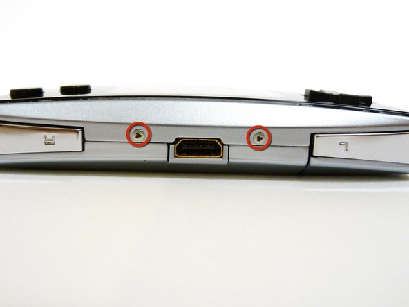

    1. Game Boy Micro Buttons Replacement, Faceplate: crwdns2935265:02crwdnd2935265:01crwdnd2935265:02crwdne2935265:0 Game Boy Micro Buttons Replacement, Faceplate: crwdns2935265:02crwdnd2935265:02crwdnd2935265:02crwdne2935265:0
      • Locate the two circular holes on the side of the Game Boy nearest to the directional pad.
    2. Game Boy Micro Buttons Replacement: crwdns2935265:03crwdnd2935265:01crwdnd2935265:03crwdne2935265:0 Game Boy Micro Buttons Replacement: crwdns2935265:03crwdnd2935265:02crwdnd2935265:03crwdne2935265:0 Game Boy Micro Buttons Replacement: crwdns2935265:03crwdnd2935265:03crwdnd2935265:03crwdne2935265:0
      • Straighten the end of a paper clip and push it into each of the circular holes.
      • You may hear a faint click afterwards.
      • Use the paper clip to lever the faceplate off from the unit.
