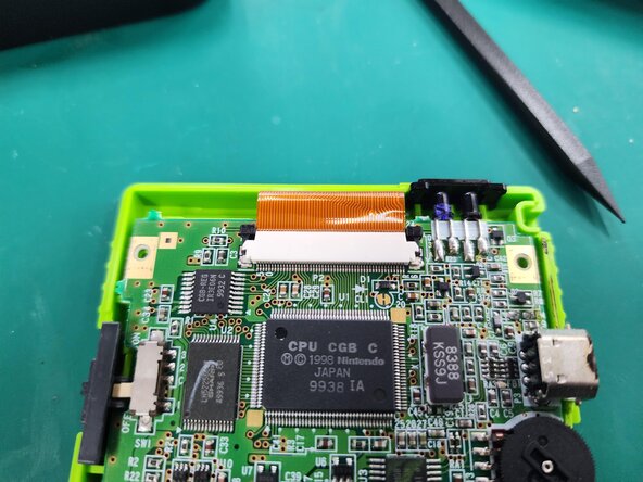

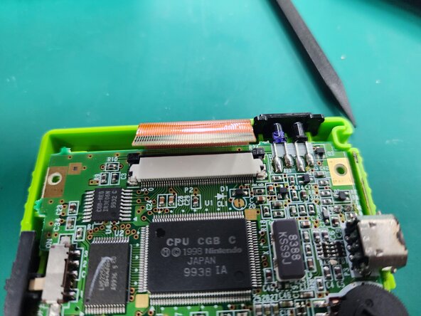

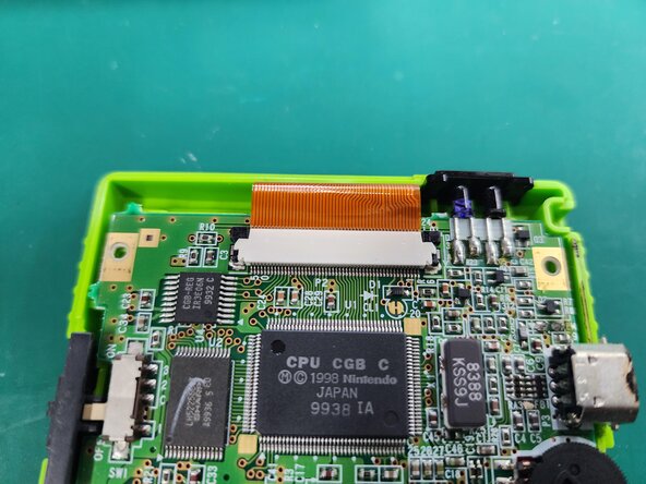

    1. Game Boy Color Buttons Replacement, LCD Ribbon Cable: crwdns2935265:05crwdnd2935265:01crwdnd2935265:03crwdne2935265:0 Game Boy Color Buttons Replacement, LCD Ribbon Cable: crwdns2935265:05crwdnd2935265:02crwdnd2935265:03crwdne2935265:0 Game Boy Color Buttons Replacement, LCD Ribbon Cable: crwdns2935265:05crwdnd2935265:03crwdnd2935265:03crwdne2935265:0
      • Push up on the tabs on either side of the ribbon with a spudger.
    2. Game Boy Color Buttons Replacement: crwdns2935265:06crwdnd2935265:01crwdnd2935265:02crwdne2935265:0 Game Boy Color Buttons Replacement: crwdns2935265:06crwdnd2935265:02crwdnd2935265:02crwdne2935265:0
      • Gently remove the ribbon cable from the port
