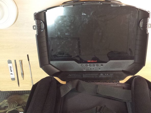

    • While the Gaems g155 takes gaming on the go, unfortunately so can the screen. Thankfully Gaems made it relatively easy to replace the screen.
  2. Gaems g155 LCD Screen Disassembly: crwdns2935265:02crwdnd2935265:01crwdnd2935265:02crwdne2935265:0 Gaems g155 LCD Screen Disassembly: crwdns2935265:02crwdnd2935265:02crwdnd2935265:02crwdne2935265:0
    • The first step is to remove the front sticker/plastic cover. You need a spudger of some sort to take the clear cover sticker and bottom sticker off.
    • Note: when you take both of the stickers off, you will most likely need to buy new stickers for the front. The clear one will no longer stick well, but the bottom one will still stick, but will have tool damage wherever you took it off (as you can see on the bottom left).

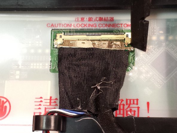

    • Looking at the back, you can see the LCD cable, most likely you will have some hot glue on the back covering the cord.
    • Be extremely careful if you do have to peel off any glue, as too much force on the cable could break the connector.
    • After any glue is removed, simply unhook cable with a spudger. Be careful not to actually touch the connectors, as the oils on your fingers can potentially cause some problems down the road.

if you use a blow dryer or heat gun on the front sticker - get it good and toasty, it comes out easier and in one piece. Also - blow dryer for the screen bezel - not too hot, but enough to loosen up the glue thats holding it down.
Last of all - on my gaems system - the connection to the lcd was both hot glue and solder - I had to use a de-soldering wick to take solder off the sides of the holding bracket.
