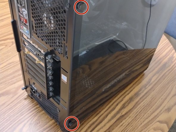

    3. GPU Replacement: crwdns2935265:03crwdnd2935265:01crwdnd2935265:02crwdne2935265:0 GPU Replacement: crwdns2935265:03crwdnd2935265:02crwdnd2935265:02crwdne2935265:0
      • Remove the screws on the side of the case.
      • Screw types may vary by desktop case.
      • These screws hold the side panel, which promotes airflow inside the desktop. Do not misplace them.
    4. GPU Replacement: crwdns2935265:04crwdnd2935265:01crwdnd2935265:02crwdne2935265:0 GPU Replacement: crwdns2935265:04crwdnd2935265:02crwdnd2935265:02crwdne2935265:0
      • Gently remove the side panel by pulling it away from the case.

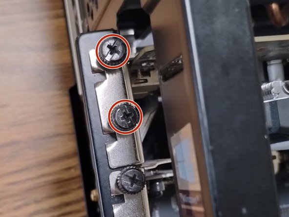

    7. GPU Replacement: crwdns2935265:07crwdnd2935265:01crwdnd2935265:02crwdne2935265:0 GPU Replacement: crwdns2935265:07crwdnd2935265:02crwdnd2935265:02crwdne2935265:0
      • Remove the UTS 6-32 screws on the side of the desktop using a Phillips #0 or a flathead screwdriver.
      • These screws hold the GPU in place. Do not misplace them.

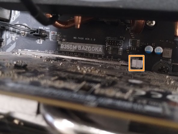

    8. GPU Replacement: crwdns2935265:08crwdnd2935265:01crwdnd2935265:02crwdne2935265:0 GPU Replacement: crwdns2935265:08crwdnd2935265:02crwdnd2935265:02crwdne2935265:0
      • Gently press down on the right side of the PCI-E tab until there is a click.
      • The click signifies the GPU has been released.

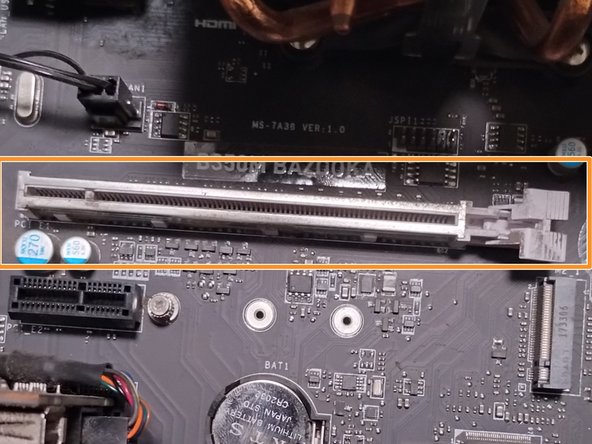

    9. GPU Replacement: crwdns2935265:09crwdnd2935265:01crwdnd2935265:01crwdne2935265:0
      • Gently pull the GPU out of the PCI-E slot.
    10. GPU Replacement: crwdns2935265:010crwdnd2935265:01crwdnd2935265:03crwdne2935265:0 GPU Replacement: crwdns2935265:010crwdnd2935265:02crwdnd2935265:03crwdne2935265:0 GPU Replacement: crwdns2935265:010crwdnd2935265:03crwdnd2935265:03crwdne2935265:0
      • Line up the pins of the new GPU with the empty PCI-E slot.
      • Gently push the new GPU into the PCI-E slot until the tab clicks.
