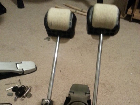

    • Lay everything out
  2. GP Percussion DP778TN Double Bass Pedal Assembly Technique: crwdns2935265:02crwdnd2935265:01crwdnd2935265:02crwdne2935265:0 GP Percussion DP778TN Double Bass Pedal Assembly Technique: crwdns2935265:02crwdnd2935265:02crwdnd2935265:02crwdne2935265:0
    • Remove the drum key and Allen wrenches from the right side of the primary pedal.
  3. GP Percussion DP778TN Double Bass Pedal Assembly Technique: crwdns2935265:03crwdnd2935265:01crwdnd2935265:02crwdne2935265:0 GP Percussion DP778TN Double Bass Pedal Assembly Technique: crwdns2935265:03crwdnd2935265:02crwdnd2935265:02crwdne2935265:0
    • Slide the ends of the long black connector onto the sides of the pedals.
    • Both sides of the connection are shaped like a half-circle, so they can only connect in the proper orientation.
    • Ensure all the screws on the connector are pointing up. To do so, you will need to "wind" the secondary pedal up manually before attaching the connector.
  4. GP Percussion DP778TN Double Bass Pedal Assembly Technique: crwdns2935265:04crwdnd2935265:01crwdnd2935265:02crwdne2935265:0 GP Percussion DP778TN Double Bass Pedal Assembly Technique: crwdns2935265:04crwdnd2935265:02crwdnd2935265:02crwdne2935265:0
    • Insert the beaters into the primary pedal.
    • You can choose to use either side of the beaters - just be consistent!
  5. GP Percussion DP778TN Double Bass Pedal Assembly Technique: crwdns2935265:05crwdnd2935265:01crwdnd2935265:03crwdne2935265:0 GP Percussion DP778TN Double Bass Pedal Assembly Technique: crwdns2935265:05crwdnd2935265:02crwdnd2935265:03crwdne2935265:0 GP Percussion DP778TN Double Bass Pedal Assembly Technique: crwdns2935265:05crwdnd2935265:03crwdnd2935265:03crwdne2935265:0
    • Arrange the pedals in the drumkit. The primary pedal should be centered on the kick drum, while the secondary pedal should be wherever comfortable.
    • If necessary use the drum key to adjust the height of the beaters to be vertically centered on the kick drum.
    • Now tighten everything down!
  6. GP Percussion DP778TN Double Bass Pedal Assembly Technique: crwdns2935265:06crwdnd2935265:01crwdnd2935265:01crwdne2935265:0
    • Tighten and loosen the nuts on the bottom of the springs until both pedals have an even, comfortable tension.
  7. GP Percussion DP778TN Double Bass Pedal Assembly Technique: crwdns2935265:07crwdnd2935265:01crwdnd2935265:02crwdne2935265:0 GP Percussion DP778TN Double Bass Pedal Assembly Technique: crwdns2935265:07crwdnd2935265:02crwdnd2935265:02crwdne2935265:0
    • Replace the tools in the pedal for safe-keeping.
    • Bag the extra parts in case you want to convert your double-bass pedal into two singles.
  8. GP Percussion DP778TN Double Bass Pedal Assembly Technique: crwdns2935265:08crwdnd2935265:01crwdnd2935265:01crwdne2935265:0
    • Pound out some sick beats!
