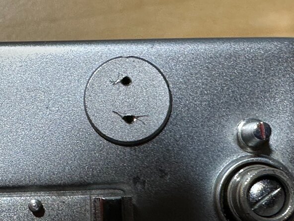

    • The vertical alignment can be adjusted without disassembling the camera top cover. However, the same adjustment can be performed with the top cover off or the RF assembly extracted.
    • Remove the adjustment screw cover by rotating it with a lens wrench or custom tool. Note that uses a bayonet mount with no threads, so at most 90˚ rotation is needed.
    • Adjust the vertical alignment as needed. The same adjustment screw is used when adjusting in a more disassembled state.

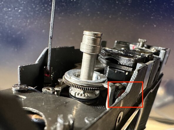

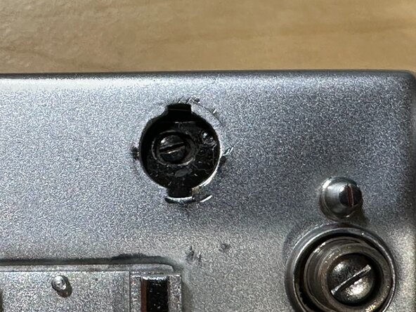

  3. GOMZ Leningrad Rangefinder Adjustment, Fine adjustment of the horizontal alignment at infinity: crwdns2935265:03crwdnd2935265:01crwdnd2935265:02crwdne2935265:0 GOMZ Leningrad Rangefinder Adjustment, Fine adjustment of the horizontal alignment at infinity: crwdns2935265:03crwdnd2935265:02crwdnd2935265:02crwdne2935265:0
    • Remove the horizontal adjustment cover screw (circled in red).
    • Mount a lens on the camera and focus to infinity. The rangefinder coupling on the lens should be calibrated.
    • Choose an object far away. With a 1mm flathead screwdriver, turn the adjustment screw so that the object is in focus on the rangefinder.
    • The location of the adjustment screw and its relative position to the cover opening is marked by the red box.
