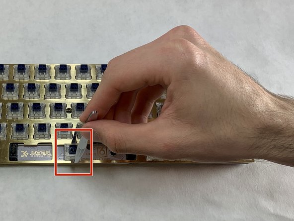

    2. GK64 Keyboard Key Switches Replacement: crwdns2935265:02crwdnd2935265:01crwdnd2935265:03crwdne2935265:0 GK64 Keyboard Key Switches Replacement: crwdns2935265:02crwdnd2935265:02crwdnd2935265:03crwdne2935265:0 GK64 Keyboard Key Switches Replacement: crwdns2935265:02crwdnd2935265:03crwdnd2935265:03crwdne2935265:0

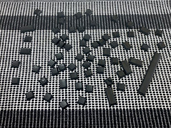

      • Never pull in a direction other than straight up. Pulling at an angle poses a high risk to damaging the underlying switch.
      • Position the wired keycap puller so the wire ends are horizontally aligned with the key and the flat ends of the wires rest under the key.
      • Rotate the wire 45 degrees and pull straight up to remove the key. This may require a bit of force, especially if you have never removed the keys before.
      • Remove every key using this method.

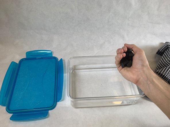

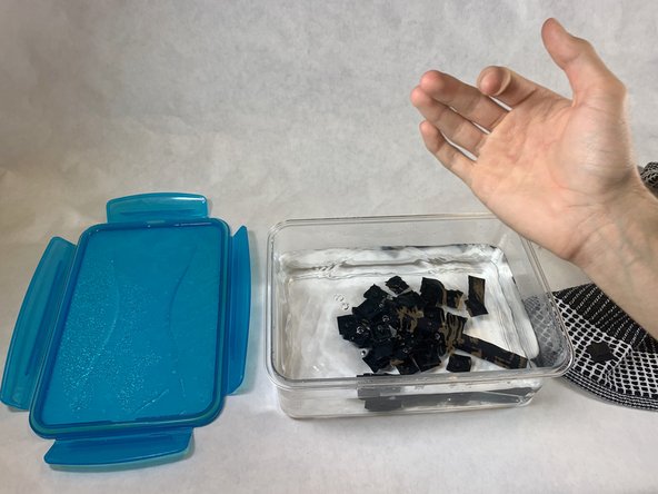

    3. GK64 Keyboard Key Switches Replacement: crwdns2935265:03crwdnd2935265:01crwdnd2935265:03crwdne2935265:0 GK64 Keyboard Key Switches Replacement: crwdns2935265:03crwdnd2935265:02crwdnd2935265:03crwdne2935265:0 GK64 Keyboard Key Switches Replacement: crwdns2935265:03crwdnd2935265:03crwdnd2935265:03crwdne2935265:0
      • Do not use isopropyl alcohol or any other solvents for this step. Isopropyl alcohol can damage the coloring and coating of the plastic keys.
      • Fill the plastic container 3/4 of the way with warm tap water.
      • Put 2 drops of dish soap into the water filled plastic container.
      • Place the keycaps in the water and ensure they are fully submerged.
      • Seal the container with the lid, and let the keycaps sit in the warm water for at least 1 hour.

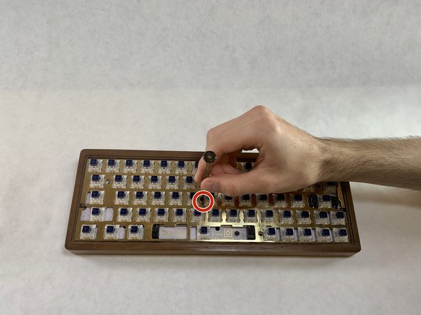

    5. GK64 Keyboard Key Switches Replacement: crwdns2935265:05crwdnd2935265:01crwdnd2935265:03crwdne2935265:0 GK64 Keyboard Key Switches Replacement: crwdns2935265:05crwdnd2935265:02crwdnd2935265:03crwdne2935265:0 GK64 Keyboard Key Switches Replacement: crwdns2935265:05crwdnd2935265:03crwdnd2935265:03crwdne2935265:0

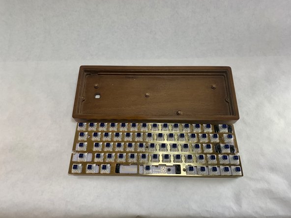

      • Unscrew all three 1.5mm screws from the PCB using a Phillips #1 screwdriver.
      • The order in which you remove the screws does not matter.
    6. GK64 Keyboard Key Switches Replacement: crwdns2935265:06crwdnd2935265:01crwdnd2935265:03crwdne2935265:0 GK64 Keyboard Key Switches Replacement: crwdns2935265:06crwdnd2935265:02crwdnd2935265:03crwdne2935265:0 GK64 Keyboard Key Switches Replacement: crwdns2935265:06crwdnd2935265:03crwdnd2935265:03crwdne2935265:0

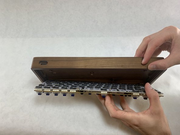

      • Do not forcefully try and detach the components. The case should come off easily. If it is not coming off easily, look for any screws you may have forgotten to remove.
      • Rotate the keyboard so it is standing on its long edge.
      • Remove the case by gently pulling it from the rest of the keyboard.

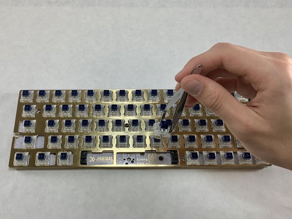

      • Do not pull in any direction other than straight up. Not pulling straight up will damage not only the switch, but also the PCB keyboard itself.
      • Hold the switch puller parallel to the faulty switch and wrap the ends around the inset of the switch.
      • Pull straight up; the switch should pop out of the PCB and case.

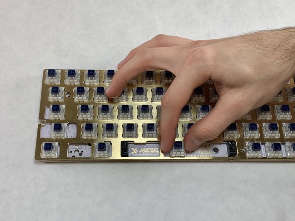

      • Never push in any direction other than straight down. It is easy to damage both the PCB keyboard and the switch in this step. You should not wiggle or bend the switch.
      • Take a replacement switch and orient it so that the two metal sockets line up with the PCB sockets.
      • Once the sockets are lined up, gently push straight down so that the switch lies flush with the plate.
      • You should hear a subtle clicking sound when you insert the switch into the PCB.

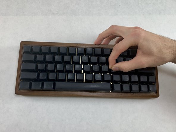

      • Place the cleaned keycaps onto their correct position on the keyboard.
      • Align the key mirroring the shape of the switch.
      • Press straight down once the keycap is aligned.
Enjoy your smooth typing!
