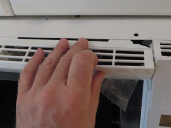

  3. GE Profile Microwave Oven Touchpad Repair, Fan Exhaust Cover: crwdns2935265:03crwdnd2935265:01crwdnd2935265:02crwdne2935265:0 GE Profile Microwave Oven Touchpad Repair, Fan Exhaust Cover: crwdns2935265:03crwdnd2935265:02crwdnd2935265:02crwdne2935265:0
    • To remove the exhaust fan cover, first pull it from the right side, until it is at the angle shown in the photo. Then pull it away moving it to the right (to slide out without hitting the microwave door).
    • You'll notice in one of the photos, that I broke the plastic tab that the screw on the right screws into. Be gentler than me. I use clear tape to hold it now.

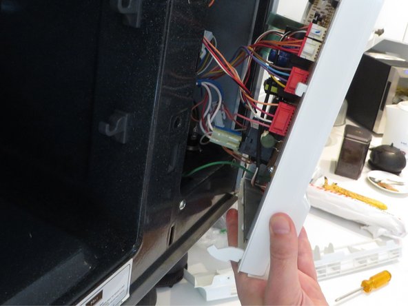

  5. GE Profile Microwave Oven Touchpad Repair, Carefully lift and pull a little: crwdns2935265:05crwdnd2935265:01crwdnd2935265:02crwdne2935265:0 GE Profile Microwave Oven Touchpad Repair, Carefully lift and pull a little: crwdns2935265:05crwdnd2935265:02crwdnd2935265:02crwdne2935265:0
    • The touch pad assembly is held on by two slim plastic tabs, which have notches in them to keep this in place. CAREFULLY push up on the touch pad assembly to lift the notches out of the metal slots. Then slowly pull it away.
    • There are lots of wires inside, which prevent you from pulling it very far. This is where it is easy to break the slim plastic tabs. The touch pad will dangle from the wires, and the tabs can break if you let the weight press on them. It's better if you have two people. But one can do it if you are careful.

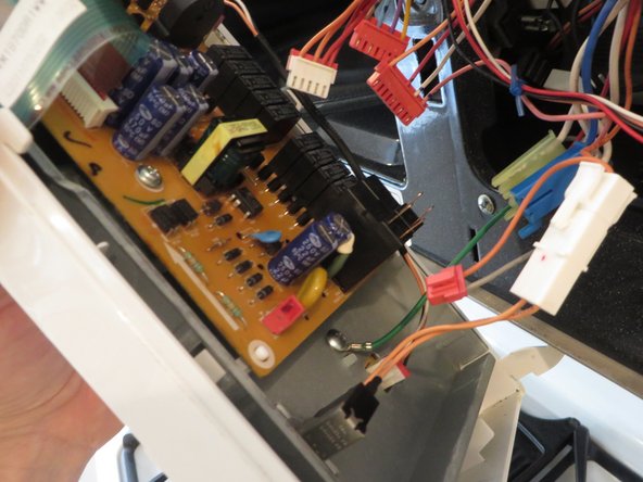

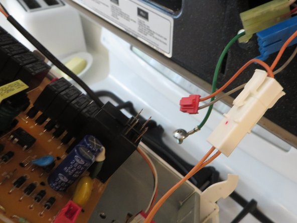

  6. GE Profile Microwave Oven Touchpad Repair, Circuit board wires and wire harnesses: crwdns2935265:06crwdnd2935265:01crwdnd2935265:03crwdne2935265:0 GE Profile Microwave Oven Touchpad Repair, Circuit board wires and wire harnesses: crwdns2935265:06crwdnd2935265:02crwdnd2935265:03crwdne2935265:0 GE Profile Microwave Oven Touchpad Repair, Circuit board wires and wire harnesses: crwdns2935265:06crwdnd2935265:03crwdnd2935265:03crwdne2935265:0
    • The first photo is a close up of the wire harnesses. Lots of wires here. At first it looked difficult, but in fact GE did a nice job here. Each wire harness is a difference size or shape, so it is fairly easy to get the wires back where they belong.
    • Before I realized it wasn't going to be a mess re-assembling, I sketched a diagram of the colors and number of connectors, just in case. But by the second time I repaired this, I didn't need to use it.
    • The second and third photos are close ups of the bottom of the circuit board. Important here is you need the screwdriver again. All the wire harnesses can be removed by squeezing and pulling. But the green ground wire is screwed in place.
