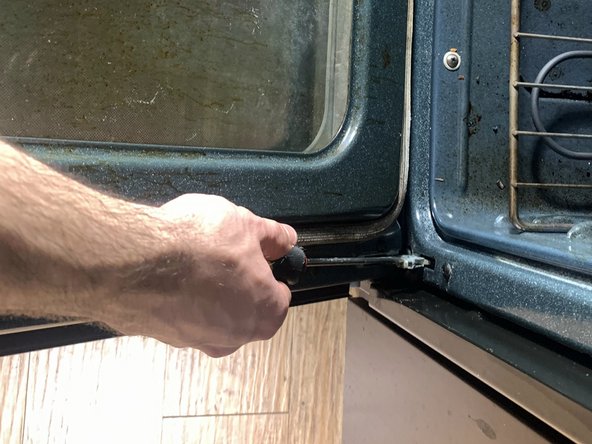

    Heavy-Duty Spudger
    • Lower the clasps on the oven door using an opening tool or heavy duty spudger.
    • Insert the spudger into the top of the metal hinge and pull it away from the door.
    • Continue to lower the clasp until met with resistance from the hinge.
    • Repeat on both sides of the oven.

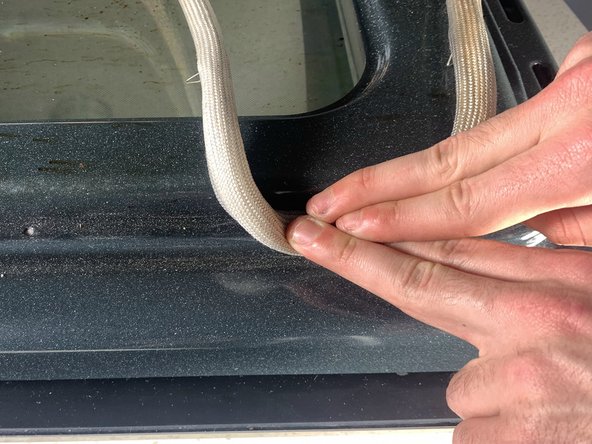

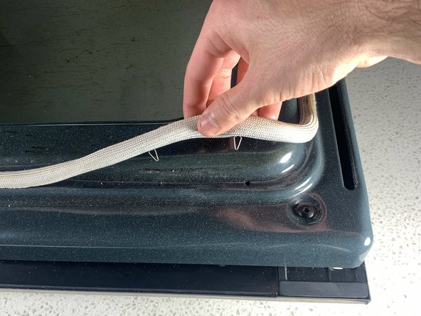

  4. GE JSP39SN4SS Door Seal Replacement: crwdns2935265:04crwdnd2935265:01crwdnd2935265:03crwdne2935265:0 GE JSP39SN4SS Door Seal Replacement: crwdns2935265:04crwdnd2935265:02crwdnd2935265:03crwdne2935265:0 GE JSP39SN4SS Door Seal Replacement: crwdns2935265:04crwdnd2935265:03crwdnd2935265:03crwdne2935265:0
    • Begin removing the seal by gently pinching and lifting away from the door.
    • Some pins may be broken. Avoid any sharp edges.
    • Any broken pins will be more difficult to remove. In order to remove them, either use more force, or pull from different angles until the metal slides out of position.

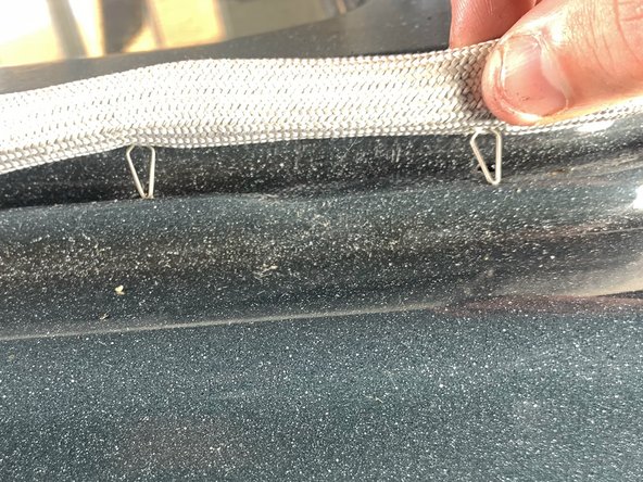

  5. GE JSP39SN4SS Door Seal Replacement: crwdns2935265:05crwdnd2935265:01crwdnd2935265:03crwdne2935265:0 GE JSP39SN4SS Door Seal Replacement: crwdns2935265:05crwdnd2935265:02crwdnd2935265:03crwdne2935265:0 GE JSP39SN4SS Door Seal Replacement: crwdns2935265:05crwdnd2935265:03crwdnd2935265:03crwdne2935265:0
    • Begin attaching the seal by inserting any pin into the holes around the door.
    • Continue to insert pins along the length of the seal.
    • Make sure each one is secure before moving onto the next.

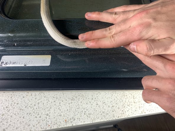

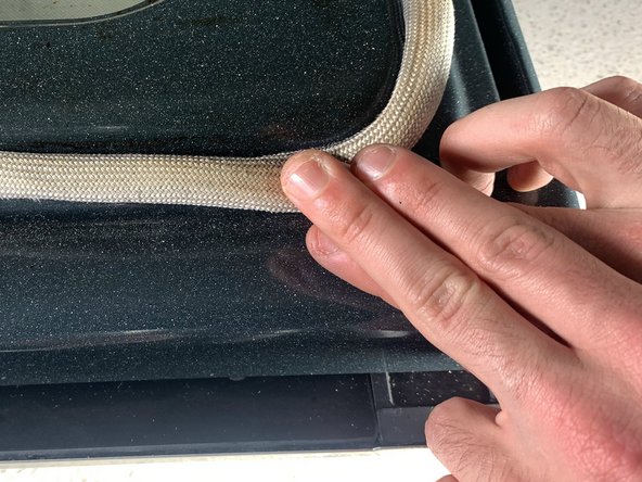

  6. GE JSP39SN4SS Door Seal Replacement: crwdns2935265:06crwdnd2935265:01crwdnd2935265:02crwdne2935265:0 GE JSP39SN4SS Door Seal Replacement: crwdns2935265:06crwdnd2935265:02crwdnd2935265:02crwdne2935265:0
    • Run your fingers over the seal to make sure all pins are in place.
    • Press firmly on any bumps in the seal.

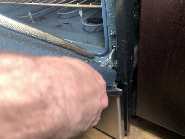

  7. GE JSP39SN4SS Door Seal Replacement: crwdns2935265:07crwdnd2935265:01crwdnd2935265:03crwdne2935265:0 GE JSP39SN4SS Door Seal Replacement: crwdns2935265:07crwdnd2935265:02crwdnd2935265:03crwdne2935265:0 GE JSP39SN4SS Door Seal Replacement: crwdns2935265:07crwdnd2935265:03crwdnd2935265:03crwdne2935265:0
    • To replace the oven door, hold it in front of the opening.
    • Insert the metal teeth into the openings, below the small metal pins, at the base of the oven.
    • If secured properly, the door should be able to rest in an open position.
    • To finish, slowly close the door. Stop if any resistance is felt.
