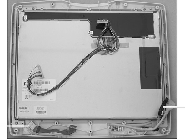

  13. GE Carescape R860 Touch Bezel Assembly Replacement, Touch Bezel Assembly: crwdns2935265:013crwdnd2935265:01crwdnd2935265:01crwdne2935265:0
    • Remove rear housing and shield (refer to “Display Unit Disassembly”).
  14. GE Carescape R860 Touch Bezel Assembly Replacement: crwdns2935265:014crwdnd2935265:01crwdnd2935265:01crwdne2935265:0
    • Disconnect the Blower fan cable (A); remove the p-clip (B) holding the harness to the Carrier board.
  15. GE Carescape R860 Touch Bezel Assembly Replacement: crwdns2935265:015crwdnd2935265:01crwdnd2935265:01crwdne2935265:0
    • Disconnect the Carrier board to LCD LVDS harness (22) - two connectors.
  16. GE Carescape R860 Touch Bezel Assembly Replacement: crwdns2935265:016crwdnd2935265:01crwdnd2935265:01crwdne2935265:0
    • Remove five LCD shield mounting screws (circled). Do not loosen any screws that are dabbed with sealing compound.
  17. GE Carescape R860 Touch Bezel Assembly Replacement: crwdns2935265:017crwdnd2935265:01crwdnd2935265:02crwdne2935265:0 GE Carescape R860 Touch Bezel Assembly Replacement: crwdns2935265:017crwdnd2935265:02crwdnd2935265:02crwdne2935265:0
    • Remove the LCD shield and Carrier board assembly from the LCD Touch Bezel assembly.
  18. GE Carescape R860 Touch Bezel Assembly Replacement: crwdns2935265:018crwdnd2935265:01crwdnd2935265:01crwdne2935265:0
    • Transfer the Carrier Board to Keypad harness (23) and the Encoder assembly (15) to the new LCD Touch Bezel assembly.
