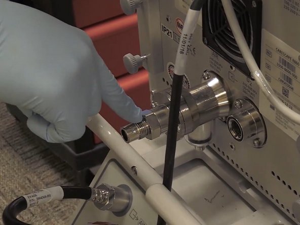

    • Disconnect the pipeline sources from the wall.
    • These are the yellow and green hoses, the air and oxygen hoses, in the image.
  2. GE Carescape R860 Air Filter Cleaning: crwdns2935265:02crwdnd2935265:01crwdnd2935265:02crwdne2935265:0 GE Carescape R860 Air Filter Cleaning: crwdns2935265:02crwdnd2935265:02crwdnd2935265:02crwdne2935265:0
    • Disconnect the oxygen hose from the machine.
    • This also includes the removal of the oxygen fitting.
  3. GE Carescape R860 Air Filter Cleaning: crwdns2935265:03crwdnd2935265:01crwdnd2935265:02crwdne2935265:0 GE Carescape R860 Air Filter Cleaning: crwdns2935265:03crwdnd2935265:02crwdnd2935265:02crwdne2935265:0
    • After the oxygen hose has been disconnected, the air hose will be disconnected as well.
    • The air line may have a compressor hose, like this unit, which will need to be removed before the air fitting can be removed.
    • Once this is done, you can look through both openings with a flashlight for debris. If there is debris, move onto the next step. Otherwise, you should reinstall the hoses to the machine and the wall
    • Open both shut-off valves.
    • Verify that the inspiratory outlet is open to atmosphere (not plugged).
    • On the VCB screen:
    • Verify that the Air and O2 Flow Valves are energized ().
    • Set the Air DAC counts to 60,000 (fully open).
    • Set the O2 DAC counts to 60,000 (fully open).
    • After 20 seconds:
    • Close both shut-off valves. Pulse the Air and O2 flow valves 5 times for 5 seconds.
    • Set the Air DAC counts to zero (closed).
    • Set the O2 DAC counts to zero (closed).
    • Note: Closing the shut-off valves before setting the flow DAC counts to zero, bleeds pressure from the system.
