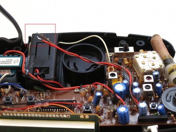

  5. GE 7-4836B Alarm Clock AM-FM Radio Speaker Replacement, Clock Radio: crwdns2935265:05crwdnd2935265:01crwdnd2935265:02crwdne2935265:0 GE 7-4836B Alarm Clock AM-FM Radio Speaker Replacement, Clock Radio: crwdns2935265:05crwdnd2935265:02crwdnd2935265:02crwdne2935265:0
    • Lift the top off. Two gray, plastic internal pieces will fall out when you do this; set them aside.

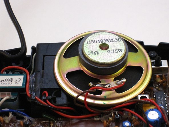

  6. GE 7-4836B Alarm Clock AM-FM Radio Speaker Replacement, Speaker: crwdns2935265:06crwdnd2935265:01crwdnd2935265:02crwdne2935265:0 GE 7-4836B Alarm Clock AM-FM Radio Speaker Replacement, Speaker: crwdns2935265:06crwdnd2935265:02crwdnd2935265:02crwdne2935265:0
    • Grip the speaker.
    • Lift the speaker from the holder.
    • Turn the speaker over.

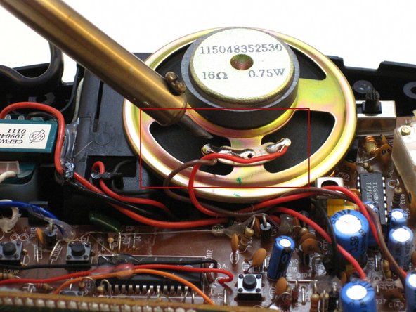

  7. GE 7-4836B Alarm Clock AM-FM Radio Speaker Replacement, Speaker from Wires: crwdns2935265:07crwdnd2935265:01crwdnd2935265:03crwdne2935265:0 GE 7-4836B Alarm Clock AM-FM Radio Speaker Replacement, Speaker from Wires: crwdns2935265:07crwdnd2935265:02crwdnd2935265:03crwdne2935265:0 GE 7-4836B Alarm Clock AM-FM Radio Speaker Replacement, Speaker from Wires: crwdns2935265:07crwdnd2935265:03crwdnd2935265:03crwdne2935265:0
    • The red wire is the + and the tan wire is the -. These wires are connected with solder.
    • Apply the hot soldering iron tip to the speaker connection solder.
    • Pull the speaker away from the wires.

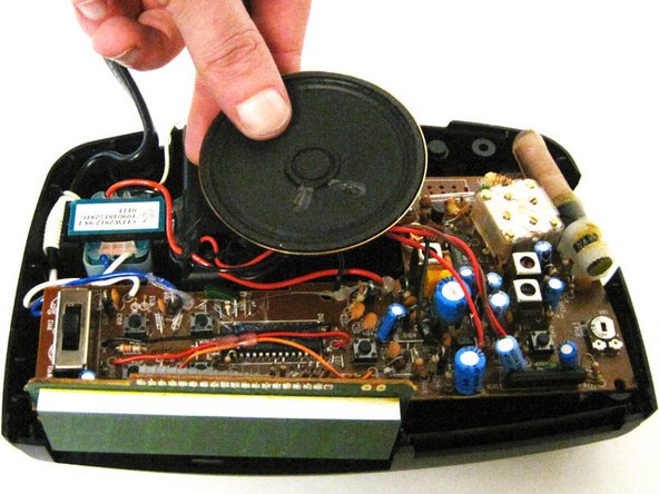

  8. GE 7-4836B Alarm Clock AM-FM Radio Speaker Replacement, New Speaker: crwdns2935265:08crwdnd2935265:01crwdnd2935265:03crwdne2935265:0 GE 7-4836B Alarm Clock AM-FM Radio Speaker Replacement, New Speaker: crwdns2935265:08crwdnd2935265:02crwdnd2935265:03crwdne2935265:0 GE 7-4836B Alarm Clock AM-FM Radio Speaker Replacement, New Speaker: crwdns2935265:08crwdnd2935265:03crwdnd2935265:03crwdne2935265:0
    • Attach a new 65 mm speaker, model #115048352530, with the wire connectors. Match the red wire to the + and the tan wire to the -.
    • Solder the wires to connect. Let the solder cool.
    • Reverse Step 6 to insert the new speaker in holder.
