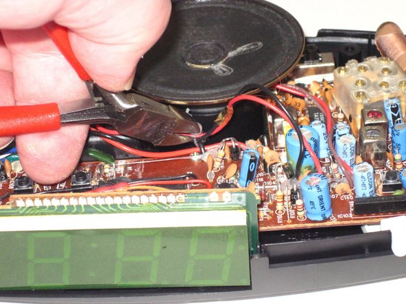

  6. GE 7-4836B Alarm Clock AM-FM Radio On/Off/Music/Alarm Switch Replacement, Battery Wires Wire Tie: crwdns2935265:06crwdnd2935265:01crwdnd2935265:02crwdne2935265:0 GE 7-4836B Alarm Clock AM-FM Radio On/Off/Music/Alarm Switch Replacement, Battery Wires Wire Tie: crwdns2935265:06crwdnd2935265:02crwdnd2935265:02crwdne2935265:0
    • Using the wire cutters, carefully cut the plastic wire tie.

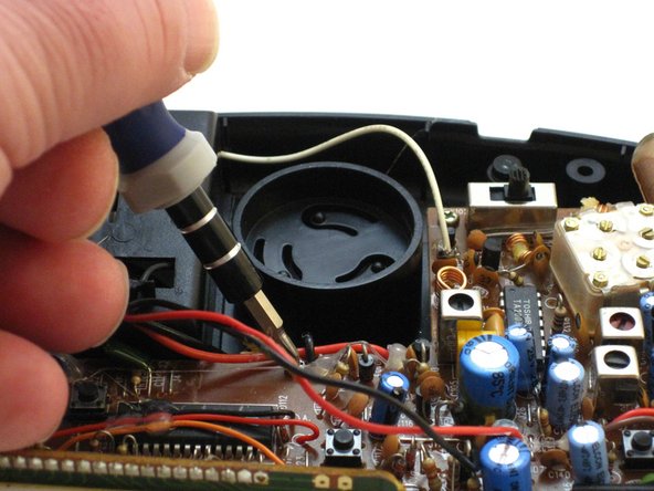

  8. GE 7-4836B Alarm Clock AM-FM Radio On/Off/Music/Alarm Switch Replacement, Two Screws: crwdns2935265:08crwdnd2935265:01crwdnd2935265:02crwdne2935265:0 GE 7-4836B Alarm Clock AM-FM Radio On/Off/Music/Alarm Switch Replacement, Two Screws: crwdns2935265:08crwdnd2935265:02crwdnd2935265:02crwdne2935265:0
    • Locate the two 6mm screws on the PCB.
    • Using a Phillips #0 Screwdriver, unscrew the two 6mm screws from the PCB.

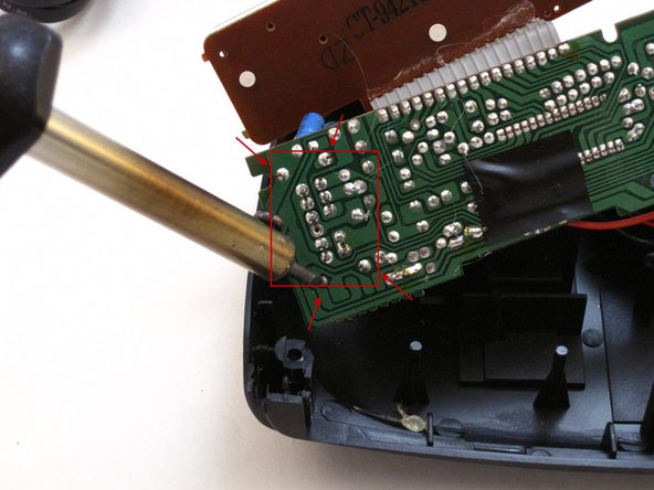

  9. GE 7-4836B Alarm Clock AM-FM Radio On/Off/Music/Alarm Switch Replacement, Four-Position Switch: crwdns2935265:09crwdnd2935265:01crwdnd2935265:02crwdne2935265:0 GE 7-4836B Alarm Clock AM-FM Radio On/Off/Music/Alarm Switch Replacement, Four-Position Switch: crwdns2935265:09crwdnd2935265:02crwdnd2935265:02crwdne2935265:0
    • Locate the four-position switch marked SW101. On the underside of the PCB, there will be 4 soldered pins as pointed at in the picture.
    • Apply the hot soldering iron to those four soldered pins to disconnect the four-position switch.
