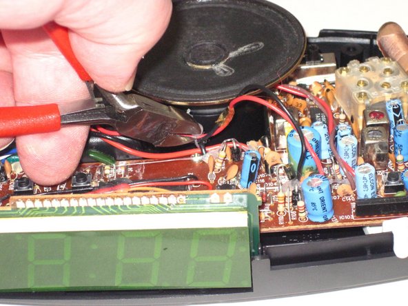

  6. GE 7-4836B Alarm Clock AM-FM Radio LCD Panel Replacement, Battery Wires Wire Tie: crwdns2935265:06crwdnd2935265:01crwdnd2935265:02crwdne2935265:0 GE 7-4836B Alarm Clock AM-FM Radio LCD Panel Replacement, Battery Wires Wire Tie: crwdns2935265:06crwdnd2935265:02crwdnd2935265:02crwdne2935265:0
    • Using the wire cutters, carefully cut the plastic wire tie.

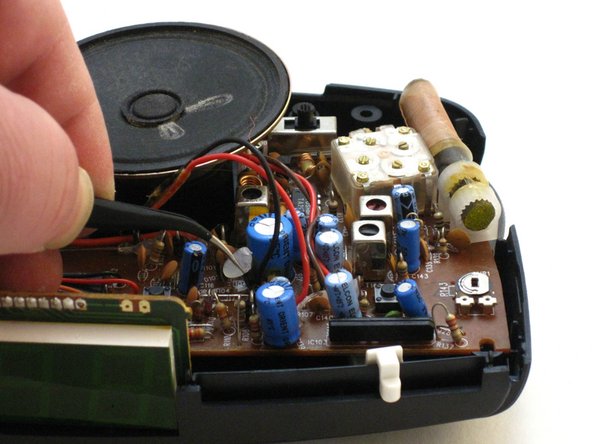

    • Apply the rubbing alcohol to the cotton swab end. Rub the end of the cotton swab on hot melt glue and wait for 30 seconds, then apply the alcohol to the hot melt glue again.
    • Use the tweezers to grab the softened hot melt glue. Pull the hot melt glue off of the clock radio.

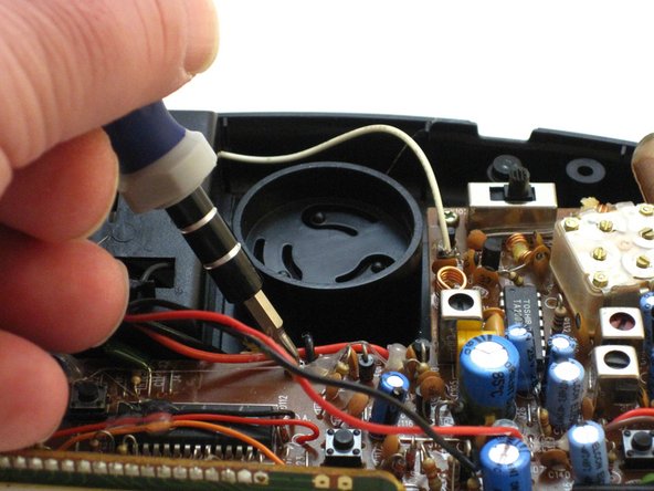

    • Locate the two 6mm screws on the PCB.
    • Using a Phillips #0 Screwdriver, unscrew the two 6 mm screws from the PCB.

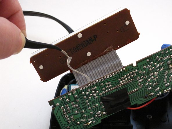

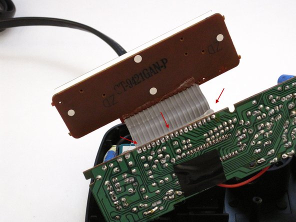

  12. GE 7-4836B Alarm Clock AM-FM Radio LCD Panel Replacement, Heated Soldering Iron: crwdns2935265:012crwdnd2935265:01crwdnd2935265:01crwdne2935265:0
    • Carefully apply the heated soldering iron on each of the 17 ribbon cable pin solders (first one as shown). Continue until the ribbon cable is detached.
