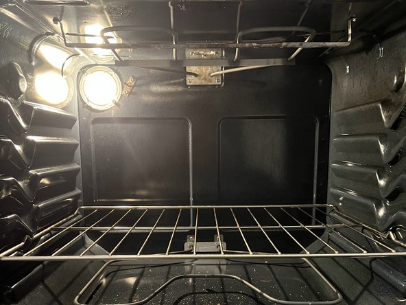

    • Make sure the oven is off and cooled down if it was on recently.
    • Open the oven door.
  2. GE 30" Electric JCB635DK6WW Oven Light Bulb Replacement: crwdns2935265:02crwdnd2935265:01crwdnd2935265:03crwdne2935265:0 GE 30" Electric JCB635DK6WW Oven Light Bulb Replacement: crwdns2935265:02crwdnd2935265:02crwdnd2935265:03crwdne2935265:0 GE 30" Electric JCB635DK6WW Oven Light Bulb Replacement: crwdns2935265:02crwdnd2935265:03crwdnd2935265:03crwdne2935265:0
    • Pull out the oven racks and remove them to reach the light bulb.
  3. GE 30" Electric JCB635DK6WW Oven Light Bulb Replacement: crwdns2935265:03crwdnd2935265:01crwdnd2935265:02crwdne2935265:0 GE 30" Electric JCB635DK6WW Oven Light Bulb Replacement: crwdns2935265:03crwdnd2935265:02crwdnd2935265:02crwdne2935265:0

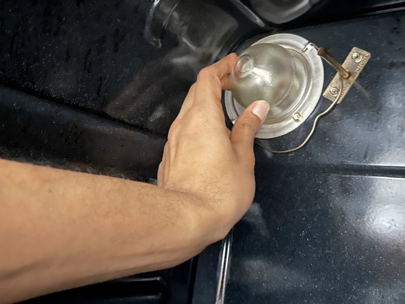

    • Move the light bulb cover latch to the right side.
    • Take off the light bulb cover to expose the burnt light bulb.
  4. GE 30" Electric JCB635DK6WW Oven Light Bulb Replacement: crwdns2935265:04crwdnd2935265:01crwdnd2935265:02crwdne2935265:0 GE 30" Electric JCB635DK6WW Oven Light Bulb Replacement: crwdns2935265:04crwdnd2935265:02crwdnd2935265:02crwdne2935265:0
    • Remove the burned out light bulb by turning clockwise.
    • Dispose of the light bulb safely according to your local guidelines.
  5. GE 30" Electric JCB635DK6WW Oven Light Bulb Replacement: crwdns2935265:05crwdnd2935265:01crwdnd2935265:02crwdne2935265:0 GE 30" Electric JCB635DK6WW Oven Light Bulb Replacement: crwdns2935265:05crwdnd2935265:02crwdnd2935265:02crwdne2935265:0
    • Screw in the new A15 light bulb.
    • Put on the light bulb cover to protect the new light bulb.
    • Don't forget to flip the latch over the light bulb cover.
