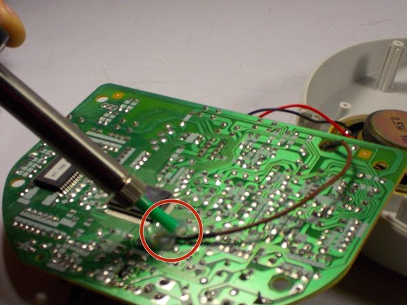

  6. GE 29875GE1 Motherboard Replacement, Disconnecting the Microphone: crwdns2935265:06crwdnd2935265:01crwdnd2935265:02crwdne2935265:0 GE 29875GE1 Motherboard Replacement, Disconnecting the Microphone: crwdns2935265:06crwdnd2935265:02crwdnd2935265:02crwdne2935265:0
    • Use the soldering iron to heat up the two solder connections where the microphone wires are attached to on the motherboard. This will separate the microphone from the board.
    • If you are having trouble with this step, refer to the guide found here.
    • Once the two screws holding the motherboard in place are removed, the motherboard can be taken out of the device and replaced.
