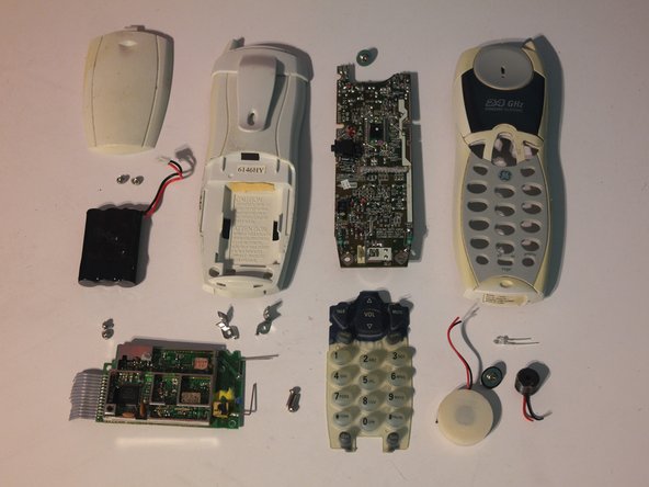

    • This is a teardown of a GE 27990G3 cordless phone system from 2001. Sadly, while it still works, its 2.4 GHz wireless transmitter interferes with WiFi.
  2. GE 27990G3 Cordless Phone Teardown: crwdns2935265:02crwdnd2935265:01crwdnd2935265:03crwdne2935265:0 GE 27990G3 Cordless Phone Teardown: crwdns2935265:02crwdnd2935265:02crwdnd2935265:03crwdne2935265:0 GE 27990G3 Cordless Phone Teardown: crwdns2935265:02crwdnd2935265:03crwdnd2935265:03crwdne2935265:0

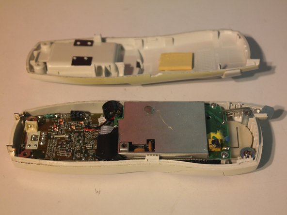

    • Part I: The Handset.
    • Remove the battery door on the back.

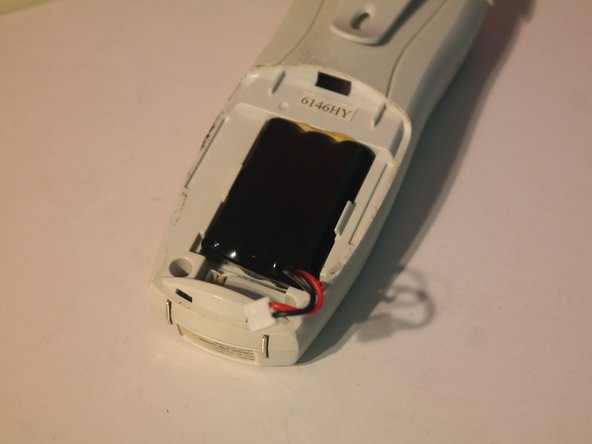

  3. GE 27990G3 Cordless Phone Teardown: crwdns2935265:03crwdnd2935265:01crwdnd2935265:03crwdne2935265:0 GE 27990G3 Cordless Phone Teardown: crwdns2935265:03crwdnd2935265:02crwdnd2935265:03crwdne2935265:0 GE 27990G3 Cordless Phone Teardown: crwdns2935265:03crwdnd2935265:03crwdnd2935265:03crwdne2935265:0
    • Use needlenose pliers to disconnect the battery connector.
    • The battery is a 3.6V Nickel-Cadmium rechargeable battery made up of 3 AAA-sized cells

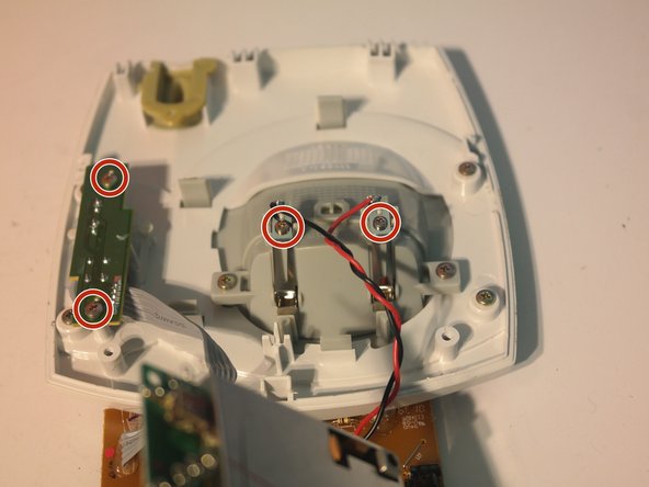

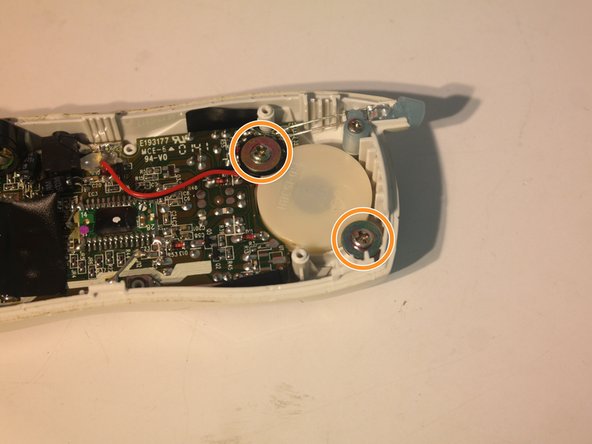

  4. GE 27990G3 Cordless Phone Teardown: crwdns2935265:04crwdnd2935265:01crwdnd2935265:01crwdne2935265:0
    • Remove 2 phillips screws inside the battery compartment.

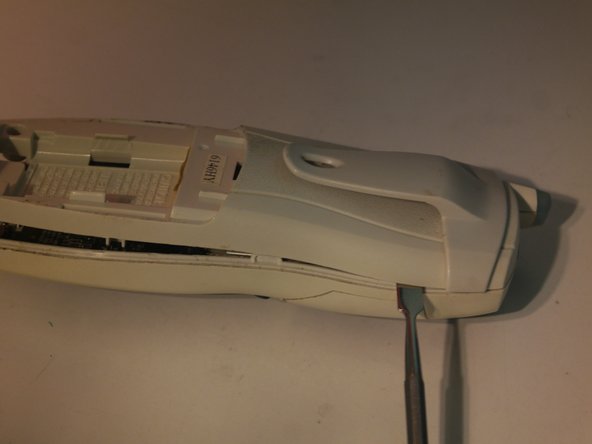

  5. GE 27990G3 Cordless Phone Teardown: crwdns2935265:05crwdnd2935265:01crwdnd2935265:03crwdne2935265:0 GE 27990G3 Cordless Phone Teardown: crwdns2935265:05crwdnd2935265:02crwdnd2935265:03crwdne2935265:0 GE 27990G3 Cordless Phone Teardown: crwdns2935265:05crwdnd2935265:03crwdnd2935265:03crwdne2935265:0
    • After some aggressive spudgering (the pictures make it look much easier), the back of the case can be removed.
  6. GE 27990G3 Cordless Phone Teardown: crwdns2935265:06crwdnd2935265:01crwdnd2935265:01crwdne2935265:0
    • The charging contacts can now be easily removed.

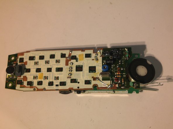

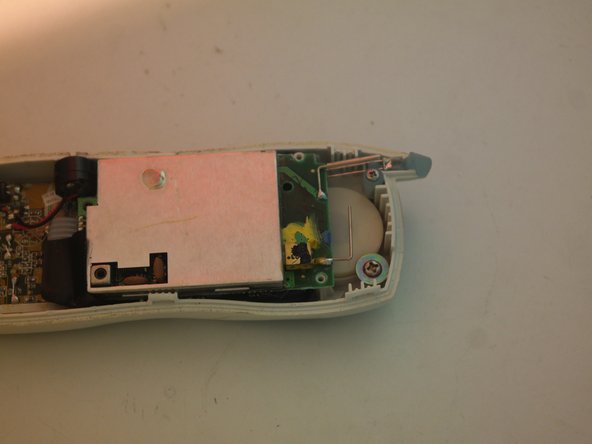

  7. GE 27990G3 Cordless Phone Teardown: crwdns2935265:07crwdnd2935265:01crwdnd2935265:02crwdne2935265:0 GE 27990G3 Cordless Phone Teardown: crwdns2935265:07crwdnd2935265:02crwdnd2935265:02crwdne2935265:0

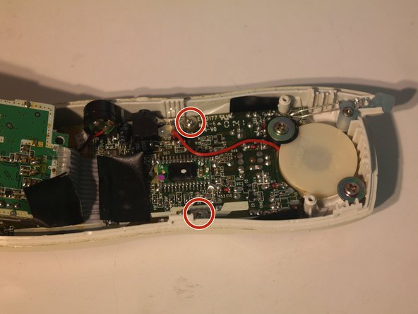

    • Remove 2 screws on what appears to be the wireless board.

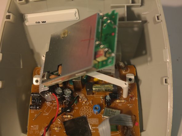

  8. GE 27990G3 Cordless Phone Teardown: crwdns2935265:08crwdnd2935265:01crwdnd2935265:03crwdne2935265:0 GE 27990G3 Cordless Phone Teardown: crwdns2935265:08crwdnd2935265:02crwdnd2935265:03crwdne2935265:0 GE 27990G3 Cordless Phone Teardown: crwdns2935265:08crwdnd2935265:03crwdnd2935265:03crwdne2935265:0

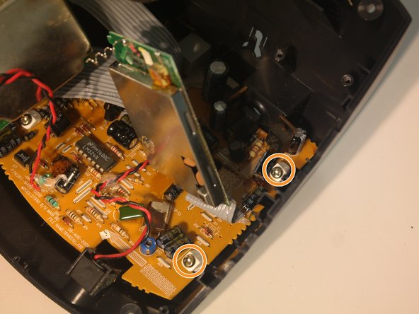

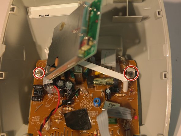

    • The wireless board can be flipped up, but is still attached to the main board by a short ribbon cable.
    • Remove 2 screws on the main board.
    • Remove 2 screws on the speaker.

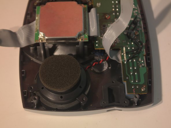

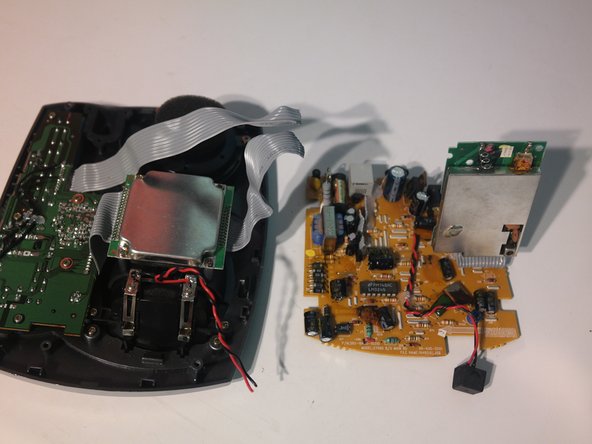

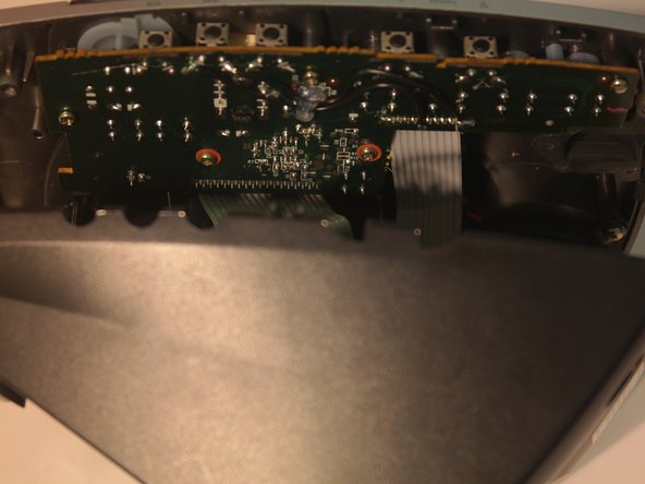

  9. GE 27990G3 Cordless Phone Teardown: crwdns2935265:09crwdnd2935265:01crwdnd2935265:02crwdne2935265:0 GE 27990G3 Cordless Phone Teardown: crwdns2935265:09crwdnd2935265:02crwdnd2935265:02crwdne2935265:0
    • The mainboard assembly can now be removed from the front case.

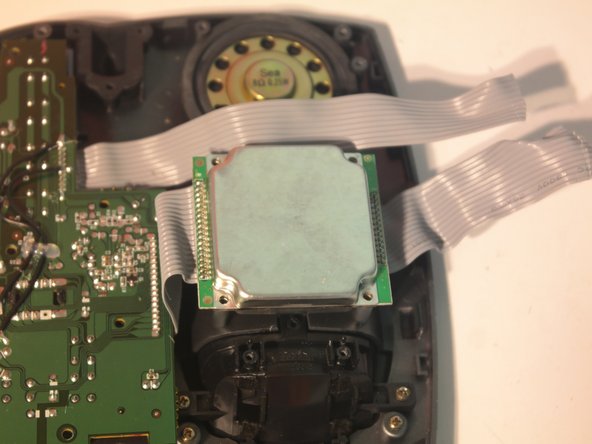

  10. GE 27990G3 Cordless Phone Teardown: crwdns2935265:010crwdnd2935265:01crwdnd2935265:02crwdne2935265:0 GE 27990G3 Cordless Phone Teardown: crwdns2935265:010crwdnd2935265:02crwdnd2935265:02crwdne2935265:0
    • The wireless board is attached by a soldered and hot-glued in ribbon cable, which must be cut off to remove.

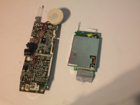

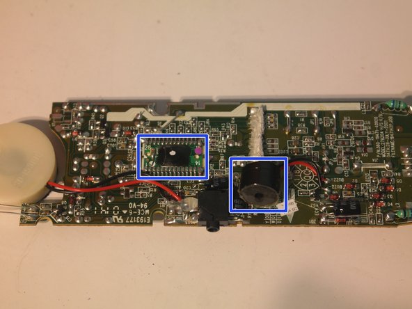

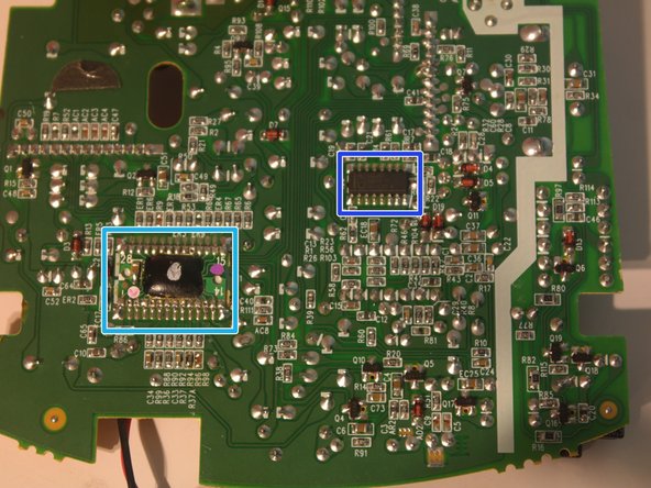

  11. GE 27990G3 Cordless Phone Teardown: crwdns2935265:011crwdnd2935265:01crwdnd2935265:02crwdne2935265:0 GE 27990G3 Cordless Phone Teardown: crwdns2935265:011crwdnd2935265:02crwdnd2935265:02crwdne2935265:0
    • Components on the main board:
    • Speaker
    • Message indicator LED
    • Ringer switch
    • Electret microphone
    • Unknown potted 'Blob' IC
    • Piezo buzzer for ringer

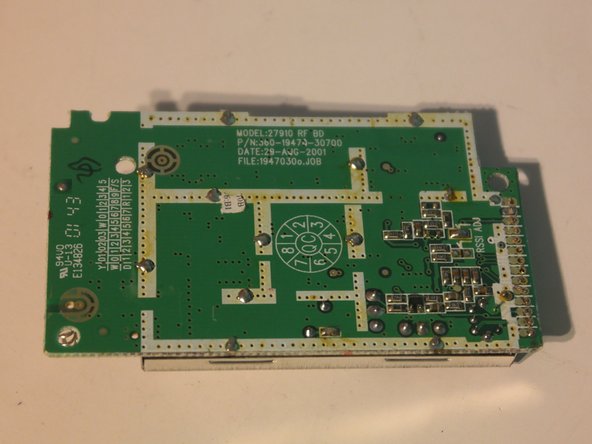

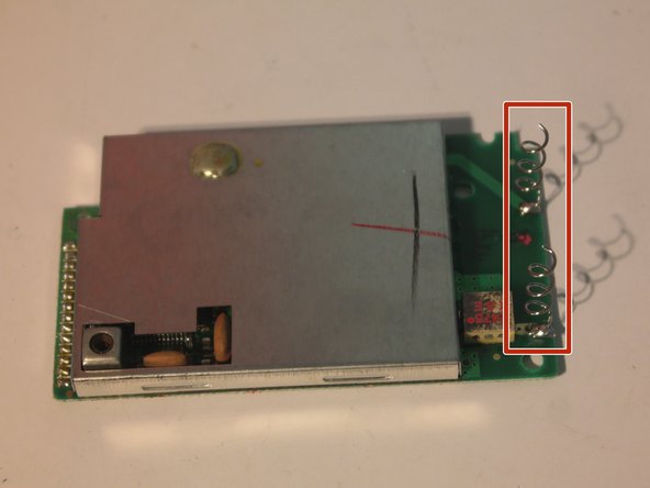

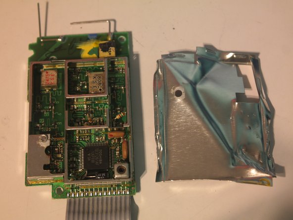

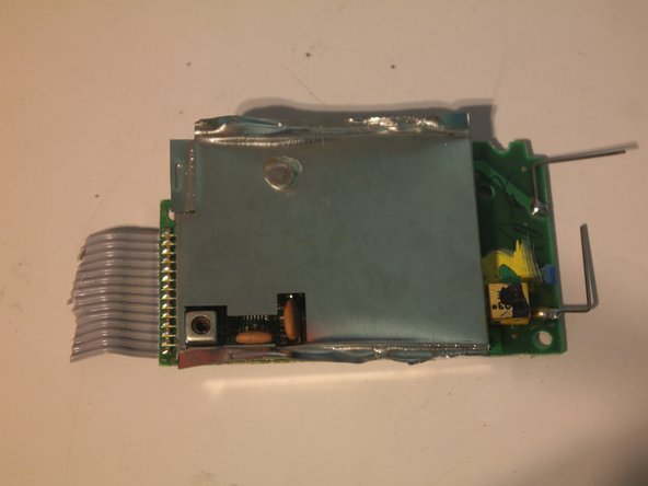

  12. GE 27990G3 Cordless Phone Teardown: crwdns2935265:012crwdnd2935265:01crwdnd2935265:03crwdne2935265:0 GE 27990G3 Cordless Phone Teardown: crwdns2935265:012crwdnd2935265:02crwdnd2935265:03crwdne2935265:0 GE 27990G3 Cordless Phone Teardown: crwdns2935265:012crwdnd2935265:03crwdnd2935265:03crwdne2935265:0
    • Whoever designed the wireless module really didn't want anyone to know what was inside. The very thick EMI shield is soldered, crimped, and epoxied on.
    • The shield took about 20 minutes to remove with diagonal cutters, 2 pairs of pliers, and 3 metal spudgers.
    • Needless to say, the shield is irreversibly damaged and the wireless module will probably never work again.

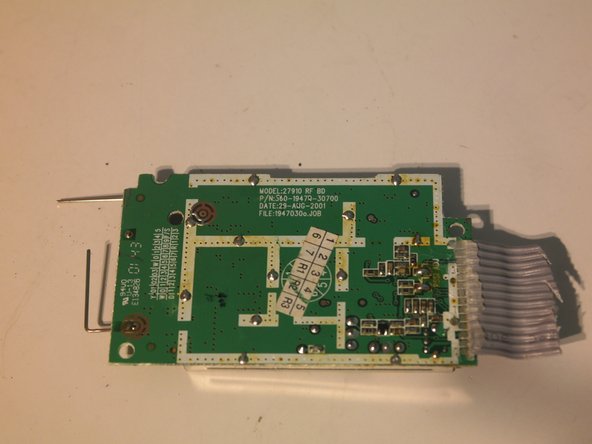

  13. GE 27990G3 Cordless Phone Teardown: crwdns2935265:013crwdnd2935265:01crwdnd2935265:02crwdne2935265:0 GE 27990G3 Cordless Phone Teardown: crwdns2935265:013crwdnd2935265:02crwdnd2935265:02crwdne2935265:0
    • Components inside the wireless module:
    • Toshiba TB31261AF cordless telephone RF chip
    • Ceramic resonators
    • Unidentified square ceramic components with 2 cylindrical holes in them horizontally (anyone who has an idea what they are, please comment.)
    • The back of the board says that it was manufactured on August 29, 2001, making the phone 14 years old at the time of writing.
    • Interestingly, the Toshiba TB31261AF is designed for a 900MHz cordless telephone, but this is a 2.4GHz model.

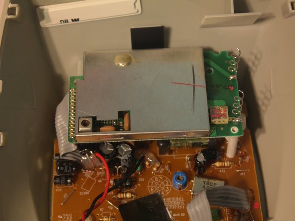

  15. GE 27990G3 Cordless Phone Teardown: crwdns2935265:015crwdnd2935265:01crwdnd2935265:02crwdne2935265:0 GE 27990G3 Cordless Phone Teardown: crwdns2935265:015crwdnd2935265:02crwdnd2935265:02crwdne2935265:0

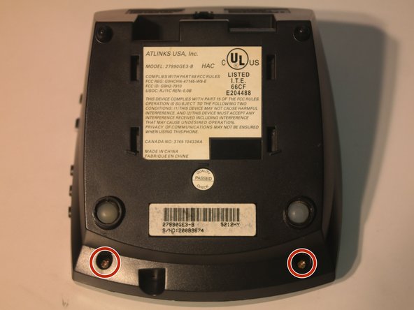

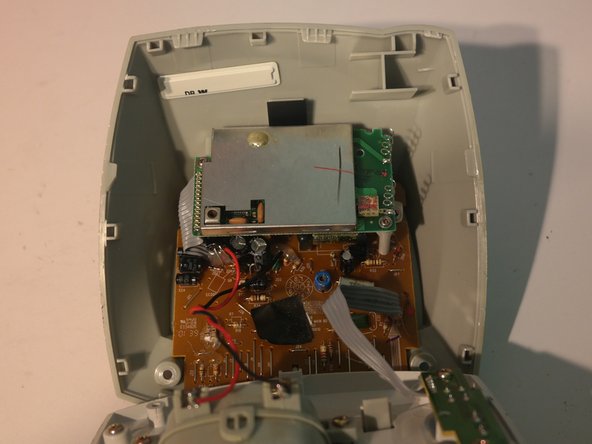

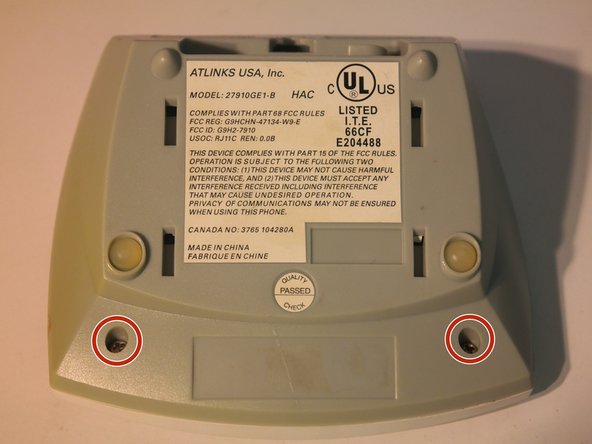

    • Part II: The Secondary Base Station
    • Remove 2 phillips screws on the bottom.

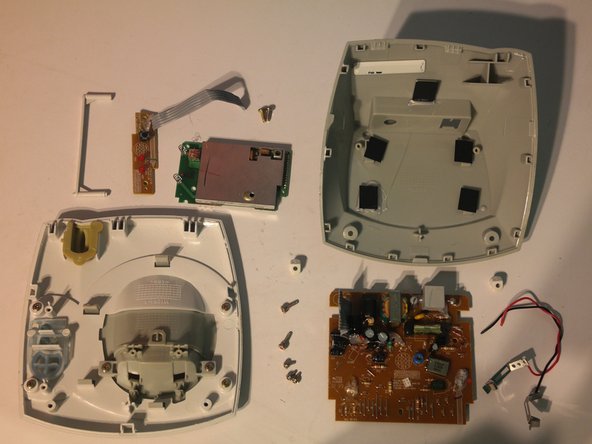

  16. GE 27990G3 Cordless Phone Teardown: crwdns2935265:016crwdnd2935265:01crwdnd2935265:03crwdne2935265:0 GE 27990G3 Cordless Phone Teardown: crwdns2935265:016crwdnd2935265:02crwdnd2935265:03crwdne2935265:0 GE 27990G3 Cordless Phone Teardown: crwdns2935265:016crwdnd2935265:03crwdnd2935265:03crwdne2935265:0
    • The top case can be removed with some spudgering.
  17. GE 27990G3 Cordless Phone Teardown: crwdns2935265:017crwdnd2935265:01crwdnd2935265:03crwdne2935265:0 GE 27990G3 Cordless Phone Teardown: crwdns2935265:017crwdnd2935265:02crwdnd2935265:03crwdne2935265:0 GE 27990G3 Cordless Phone Teardown: crwdns2935265:017crwdnd2935265:03crwdnd2935265:03crwdne2935265:0

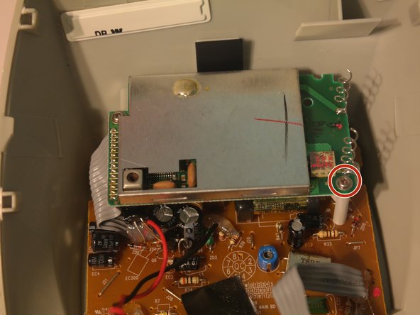

    • Remove 1 screw to remove the wireless module.
  18. GE 27990G3 Cordless Phone Teardown: crwdns2935265:018crwdnd2935265:01crwdnd2935265:03crwdne2935265:0 GE 27990G3 Cordless Phone Teardown: crwdns2935265:018crwdnd2935265:02crwdnd2935265:03crwdne2935265:0 GE 27990G3 Cordless Phone Teardown: crwdns2935265:018crwdnd2935265:03crwdnd2935265:03crwdne2935265:0
    • Just like in the handset, the wireless module is connected to the main board with a soldered ribbon cable. I'm sensing a theme here.
    • Remove 2 screws that hold down the main board.
  19. GE 27990G3 Cordless Phone Teardown: crwdns2935265:019crwdnd2935265:01crwdnd2935265:03crwdne2935265:0 GE 27990G3 Cordless Phone Teardown: crwdns2935265:019crwdnd2935265:02crwdnd2935265:03crwdne2935265:0 GE 27990G3 Cordless Phone Teardown: crwdns2935265:019crwdnd2935265:03crwdnd2935265:03crwdne2935265:0
    • The main circuit board can be removed from the bottom case.
    • Remove 4 screws holding in the button board and charging contacts from the top case.
  20. GE 27990G3 Cordless Phone Teardown: crwdns2935265:020crwdnd2935265:01crwdnd2935265:03crwdne2935265:0 GE 27990G3 Cordless Phone Teardown: crwdns2935265:020crwdnd2935265:02crwdnd2935265:03crwdne2935265:0 GE 27990G3 Cordless Phone Teardown: crwdns2935265:020crwdnd2935265:03crwdnd2935265:03crwdne2935265:0
    • The wireless module can be cut away from the logic board.
    • This wireless module is identical to the one in the handset except for the fact that it used coiled wires instead of straight wires for antennas.

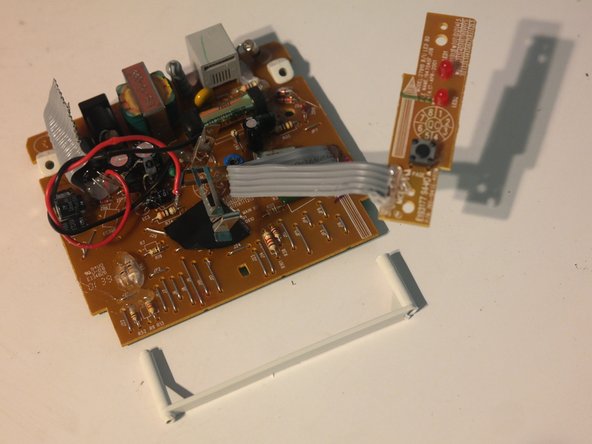

  21. GE 27990G3 Cordless Phone Teardown: crwdns2935265:021crwdnd2935265:01crwdnd2935265:02crwdne2935265:0 GE 27990G3 Cordless Phone Teardown: crwdns2935265:021crwdnd2935265:02crwdnd2935265:02crwdne2935265:0
    • Remove 2 screws to remove the support for the wireless module.
    • The plastic pieces used to hold down the board can also be removed.
  22. GE 27990G3 Cordless Phone Teardown: crwdns2935265:022crwdnd2935265:01crwdnd2935265:01crwdne2935265:0
    • The button board contains a lonely button, 2 LEDs, and is connected with a soldered ribbon cable reinforced with hot glue.
    • This board appears to have been manufactured on April 17, 2001.

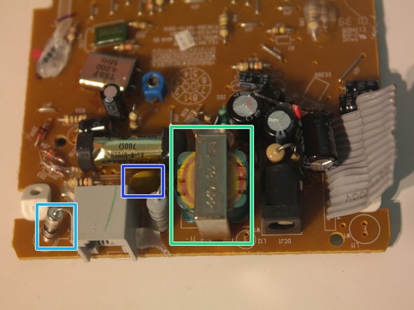

    • 4 MHz crystal
    • Reed relay
    • Variable capacitor
    • Small audio transformer
    • Miniature fuse
    • Varistor for surge protection
    • This board was manufactured on September 3, 2001.

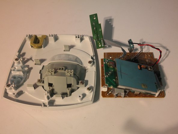

    • Part III: The Main Base Station
    • First step: remove 4 screws.

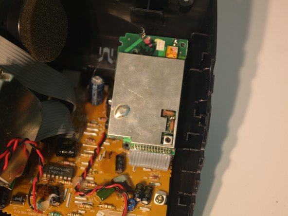

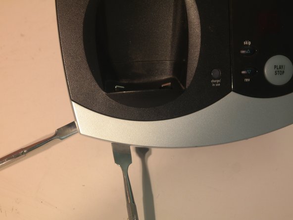

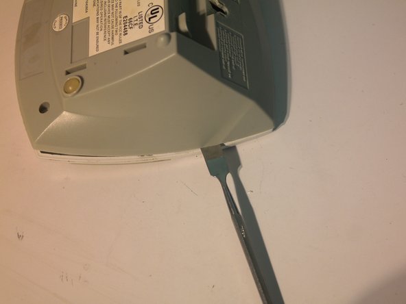

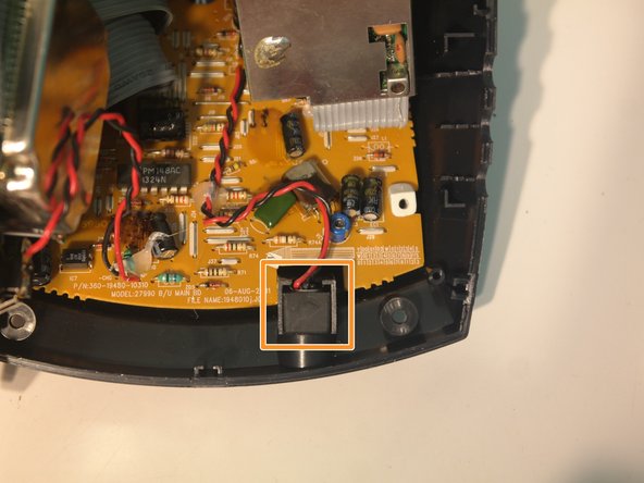

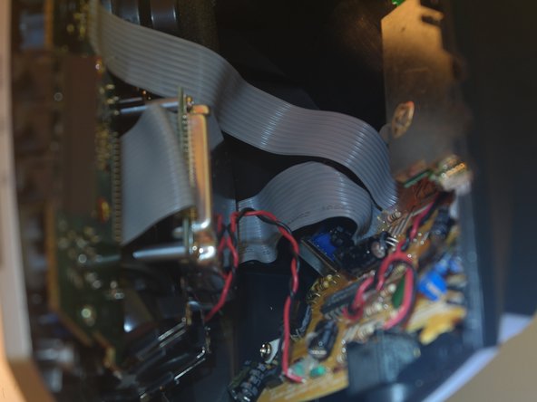

  26. GE 27990G3 Cordless Phone Teardown: crwdns2935265:026crwdnd2935265:01crwdnd2935265:03crwdne2935265:0 GE 27990G3 Cordless Phone Teardown: crwdns2935265:026crwdnd2935265:02crwdnd2935265:03crwdne2935265:0 GE 27990G3 Cordless Phone Teardown: crwdns2935265:026crwdnd2935265:03crwdnd2935265:03crwdne2935265:0
    • The case for the main base station can be opened, but it requires 2 spudgers and much more force than the other one.
    • Remember how I said soldered ribbon cables were becoming a theme here? I was right.
  27. GE 27990G3 Cordless Phone Teardown: crwdns2935265:027crwdnd2935265:01crwdnd2935265:02crwdne2935265:0 GE 27990G3 Cordless Phone Teardown: crwdns2935265:027crwdnd2935265:02crwdnd2935265:02crwdne2935265:0
    • Remove the buttons from the side of the case.
  28. GE 27990G3 Cordless Phone Teardown: crwdns2935265:028crwdnd2935265:01crwdnd2935265:03crwdne2935265:0 GE 27990G3 Cordless Phone Teardown: crwdns2935265:028crwdnd2935265:02crwdnd2935265:03crwdne2935265:0 GE 27990G3 Cordless Phone Teardown: crwdns2935265:028crwdnd2935265:03crwdnd2935265:03crwdne2935265:0
    • Remove 2 screws holding down the wireless module.
    • Remove 2 more screws holding down the plastic pieces attached to the circuit board.
  29. GE 27990G3 Cordless Phone Teardown: crwdns2935265:029crwdnd2935265:01crwdnd2935265:02crwdne2935265:0 GE 27990G3 Cordless Phone Teardown: crwdns2935265:029crwdnd2935265:02crwdnd2935265:02crwdne2935265:0
    • Remove another 2 screws on the other side of the board.
    • Remove the microphone from its holder.
  30. GE 27990G3 Cordless Phone Teardown: crwdns2935265:030crwdnd2935265:01crwdnd2935265:03crwdne2935265:0 GE 27990G3 Cordless Phone Teardown: crwdns2935265:030crwdnd2935265:02crwdnd2935265:03crwdne2935265:0 GE 27990G3 Cordless Phone Teardown: crwdns2935265:030crwdnd2935265:03crwdnd2935265:03crwdne2935265:0
    • In order to remove the board from the bottom case, you have to carefully reach in and free each one of the plastic pieces attached to the board from a clip on the bottom case.
    • All of the cables to the main board can now be cut and the wireless module can be cut off of the main board.

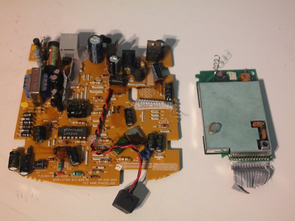

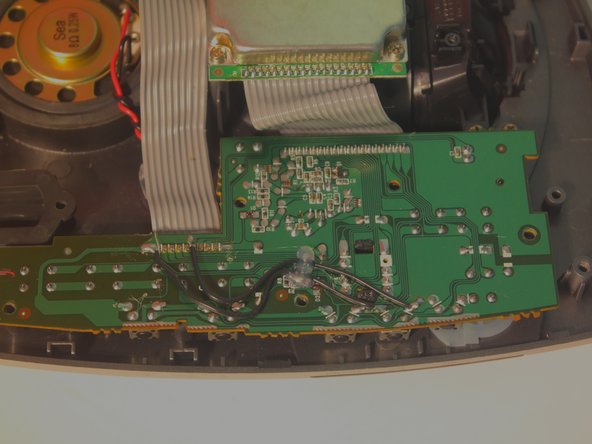

  31. GE 27990G3 Cordless Phone Teardown: crwdns2935265:031crwdnd2935265:01crwdnd2935265:02crwdne2935265:0 GE 27990G3 Cordless Phone Teardown: crwdns2935265:031crwdnd2935265:02crwdnd2935265:02crwdne2935265:0
    • LM324 Quad Operational Amplifier
    • Reed relay
    • Same potted 'Blob' IC found in the handset
    • HEF4053 triple SPDT analog switch

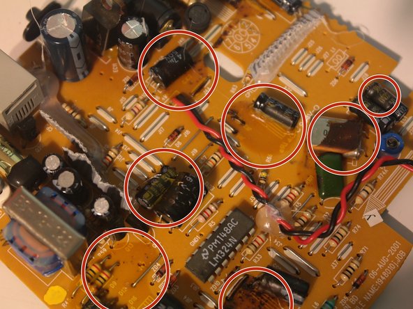

  32. GE 27990G3 Cordless Phone Teardown: crwdns2935265:032crwdnd2935265:01crwdnd2935265:02crwdne2935265:0 GE 27990G3 Cordless Phone Teardown: crwdns2935265:032crwdnd2935265:02crwdnd2935265:02crwdne2935265:0

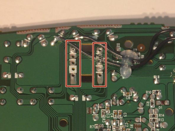

    • The main board in the base station has patches of an unknown yellowish-brown substance on it that appears to be some kind of weak adhesive, and it seems to be scattered in no obvious pattern.
  33. GE 27990G3 Cordless Phone Teardown: crwdns2935265:033crwdnd2935265:01crwdnd2935265:02crwdne2935265:0 GE 27990G3 Cordless Phone Teardown: crwdns2935265:033crwdnd2935265:02crwdnd2935265:02crwdne2935265:0

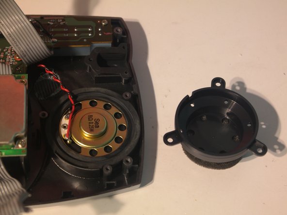

    • Remove 3 screws to remove the speaker cover.
    • This speaker cover appears to have been designed to accomodate both a low-profile speaker and a speaker with a larger magnet on the back.

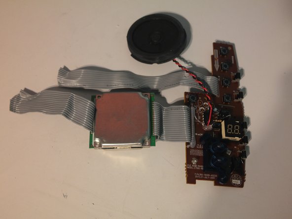

    • Remove 4 screws on the mysterious metal box.
  37. GE 27990G3 Cordless Phone Teardown: crwdns2935265:037crwdnd2935265:01crwdnd2935265:02crwdne2935265:0 GE 27990G3 Cordless Phone Teardown: crwdns2935265:037crwdnd2935265:02crwdnd2935265:02crwdne2935265:0
    • The entire top case assembly can be removed from the printer after using a spudger to free the large buttons from clips in the top case.
  38. GE 27990G3 Cordless Phone Teardown: crwdns2935265:038crwdnd2935265:01crwdnd2935265:03crwdne2935265:0 GE 27990G3 Cordless Phone Teardown: crwdns2935265:038crwdnd2935265:02crwdnd2935265:03crwdne2935265:0 GE 27990G3 Cordless Phone Teardown: crwdns2935265:038crwdnd2935265:03crwdnd2935265:03crwdne2935265:0

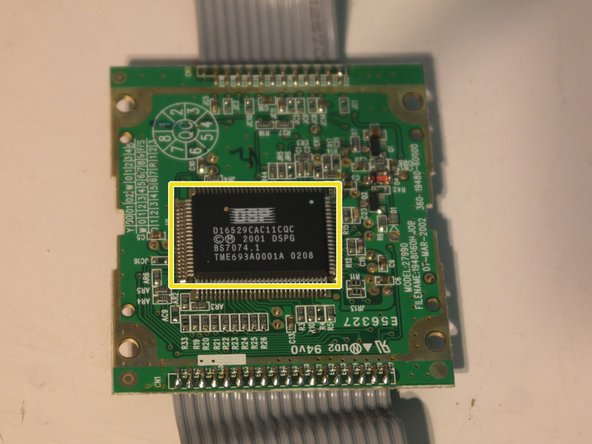

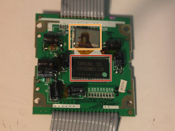

    • So what is inside the mysterious metal box?
    • Samsung K9F4008W0A-TCB0 512x8 Kb (512 KB) flash memory (designed for digital audio recording)
    • Crystal oscillator, covered in the same unusual substance found on the main board.
    • Unknown IC D16529CAC11CQC. Googling it turns up nothing that makes any sense.
    • This board is probably where the messages are stored.

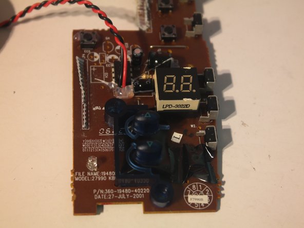

  39. GE 27990G3 Cordless Phone Teardown: crwdns2935265:039crwdnd2935265:01crwdnd2935265:03crwdne2935265:0 GE 27990G3 Cordless Phone Teardown: crwdns2935265:039crwdnd2935265:02crwdnd2935265:03crwdne2935265:0 GE 27990G3 Cordless Phone Teardown: crwdns2935265:039crwdnd2935265:03crwdnd2935265:03crwdne2935265:0
    • The major components on the top case board:
    • Dual 7-segment display
    • LM386 audio amplifier
    • This board was manufactured on July 27, 2001.

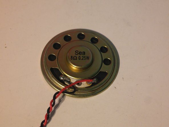

    • The speaker is a standard 2" low profile 8 ohm 0.25 watt speaker.
  40. GE 27990G3 Cordless Phone Teardown: crwdns2935265:040crwdnd2935265:01crwdnd2935265:02crwdne2935265:0 GE 27990G3 Cordless Phone Teardown: crwdns2935265:040crwdnd2935265:02crwdnd2935265:02crwdne2935265:0
    • All of the boards in this phone system have terrible solder quality. I was able to cleanly remove the 7-segment display, about 20 capacitors, 3 voltage regulators, 1 transformer, and 2 crystal oscillators without damaging them using needle nose pliers.
  41. GE 27990G3 Cordless Phone Teardown: crwdns2935265:041crwdnd2935265:01crwdnd2935265:01crwdne2935265:0
