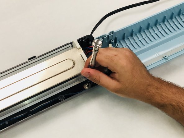

    • Using the Phillips #2 screwdriver, remove ten 12 mm long screws on the bottom of the device.
  2. GBC Creative Laminator Motor Replacement: crwdns2935265:02crwdnd2935265:01crwdnd2935265:01crwdne2935265:0
    • Open the top of the device, and the inside of the Laminator will be exposed as shown.
  3. GBC Creative Laminator Motor Replacement: crwdns2935265:03crwdnd2935265:01crwdnd2935265:02crwdne2935265:0 GBC Creative Laminator Motor Replacement: crwdns2935265:03crwdnd2935265:02crwdnd2935265:02crwdne2935265:0
    • Using the Phillips #2 screwdriver, remove two 9 mm long screws on the side of the main component that keep the motor in place.
  4. GBC Creative Laminator Motor Replacement: crwdns2935265:04crwdnd2935265:01crwdnd2935265:02crwdne2935265:0 GBC Creative Laminator Motor Replacement: crwdns2935265:04crwdnd2935265:02crwdnd2935265:02crwdne2935265:0
    • Using the Phillips #2 screwdriver, remove three 8.5 mm long screws and washers on the front edge of the plastic casing.
  5. GBC Creative Laminator Motor Replacement: crwdns2935265:05crwdnd2935265:01crwdnd2935265:01crwdne2935265:0
    • Lift the motor out of the plastic casing.
