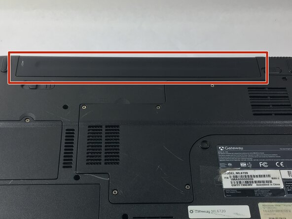

      • Locate the battery at the very top on the backside of the laptop.
    2. GATEWAY ML6720 Keyboard Replacement: crwdns2935265:03crwdnd2935265:01crwdnd2935265:01crwdne2935265:0

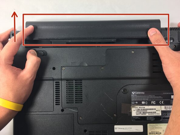

      • Slide the latch in the top right corner to the right, to set it to unlocked.
    3. GATEWAY ML6720 Keyboard Replacement: crwdns2935265:04crwdnd2935265:01crwdnd2935265:01crwdne2935265:0
      • Hold the other latch in the top left corner to the left.
      • Hold it in that place with your thumb until the completion of the next step. (This step unlocks the second latch.)
    4. GATEWAY ML6720 Keyboard Replacement: crwdns2935265:05crwdnd2935265:01crwdnd2935265:01crwdne2935265:0
      • With both latches unlocked you can now slide out the battery, by pushing it off the top.

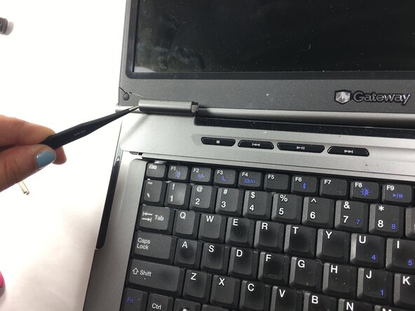

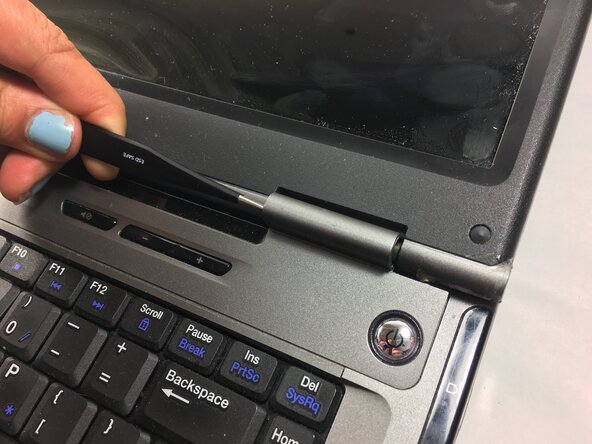

    3. GATEWAY ML6720 Keyboard Replacement: crwdns2935265:08crwdnd2935265:01crwdnd2935265:02crwdne2935265:0 GATEWAY ML6720 Keyboard Replacement: crwdns2935265:08crwdnd2935265:02crwdnd2935265:02crwdne2935265:0
      • Using a pair of tweezers or the tip of your screw driver, dig into the laptop cover and apply force to pop it out.
      • Do this on the left and right side of the cover.

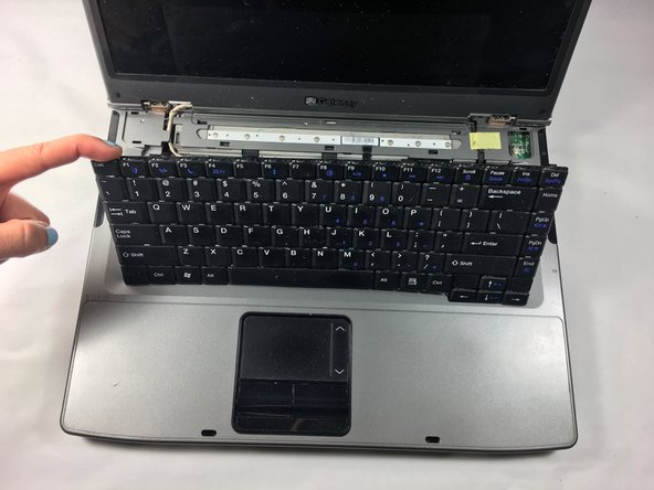

    4. GATEWAY ML6720 Keyboard Replacement: crwdns2935265:09crwdnd2935265:01crwdnd2935265:02crwdne2935265:0 GATEWAY ML6720 Keyboard Replacement: crwdns2935265:09crwdnd2935265:02crwdnd2935265:02crwdne2935265:0
      • Pull up the keyboard with your finger.
