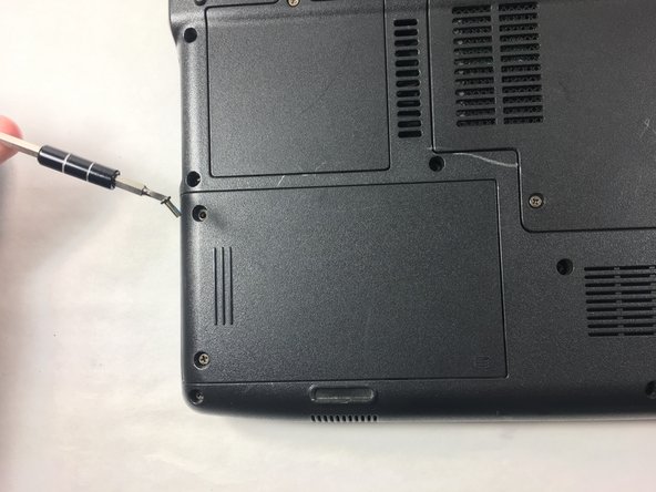

    • Flip the laptop on to its backside.
  2. GATEWAY ML6720 Hard Drive Replacement: crwdns2935265:02crwdnd2935265:01crwdnd2935265:01crwdne2935265:0
    • Locate the hard drive at the bottom left corner of the laptop's backside.
  3. GATEWAY ML6720 Hard Drive Replacement: crwdns2935265:03crwdnd2935265:01crwdnd2935265:02crwdne2935265:0 GATEWAY ML6720 Hard Drive Replacement: crwdns2935265:03crwdnd2935265:02crwdnd2935265:02crwdne2935265:0
    • Insert the correct screwdriver mentioned in this guide.
    • Fully loosen and remove each of the two screws located at the top left and bottom left corners of the hard drive's cover plate.
  4. GATEWAY ML6720 Hard Drive Replacement: crwdns2935265:04crwdnd2935265:01crwdnd2935265:01crwdne2935265:0
    • Slide the hard drive's cover plate out to the left and take it off.
  5. GATEWAY ML6720 Hard Drive Replacement: crwdns2935265:05crwdnd2935265:01crwdnd2935265:01crwdne2935265:0
    • Pop the hard drive out of the compartment.
