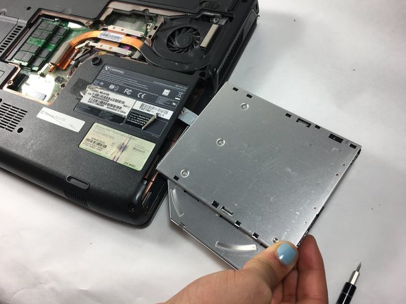

    • Remove the six screws with the Phillips #0 Screwdriver that secures the middle large piece of the back panel.
  2. GATEWAY ML6720 Disc Drive Replacement: crwdns2935265:02crwdnd2935265:01crwdnd2935265:02crwdne2935265:0 GATEWAY ML6720 Disc Drive Replacement: crwdns2935265:02crwdnd2935265:02crwdnd2935265:02crwdne2935265:0
    • Check to see if your laptop requires a screw(s) to be removed for the disc drive. Remove the screw (s) holding the disc drive down.
  3. GATEWAY ML6720 Disc Drive Replacement: crwdns2935265:03crwdnd2935265:01crwdnd2935265:02crwdne2935265:0 GATEWAY ML6720 Disc Drive Replacement: crwdns2935265:03crwdnd2935265:02crwdnd2935265:02crwdne2935265:0
    • With that screw removed, you can now pull the disc drive out of the laptop by pulling on it in the direction that it slides.
