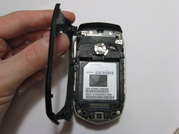

    • Turn locking device on back side of phone marked by the rectangle counter clockwise.
  2. G'z One Boulder New Antenna Replacement: crwdns2935265:02crwdnd2935265:01crwdnd2935265:01crwdne2935265:0
    • Remove battery by grabbing the sides and pulling upward.
    • If battery was malfunctioning due to age or corrosion, there may be battery acid residue on the battery and the back of the phone. Wear gloves in order to prevent skin irritation.

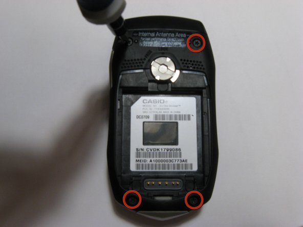

  3. G'z One Boulder New Antenna Replacement, New Antenna: crwdns2935265:03crwdnd2935265:01crwdnd2935265:03crwdne2935265:0 G'z One Boulder New Antenna Replacement, New Antenna: crwdns2935265:03crwdnd2935265:02crwdnd2935265:03crwdne2935265:0 G'z One Boulder New Antenna Replacement, New Antenna: crwdns2935265:03crwdnd2935265:03crwdnd2935265:03crwdne2935265:0
    • Remove back cover by taking out the four, five point star screws indicated in the picture. A 1.5mm flathead screwdriver can be used to remove the screws.
    • Once all screws are removed the case will easily lift off.

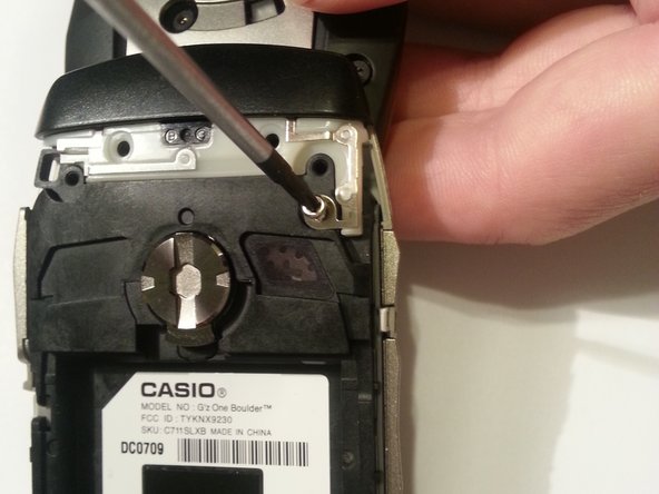

  4. G'z One Boulder New Antenna Replacement: crwdns2935265:04crwdnd2935265:01crwdnd2935265:02crwdne2935265:0 G'z One Boulder New Antenna Replacement: crwdns2935265:04crwdnd2935265:02crwdnd2935265:02crwdne2935265:0
    • With the back cover removed, the antenna is now exposed. To remove it, take out the phillips screw holding it in place.

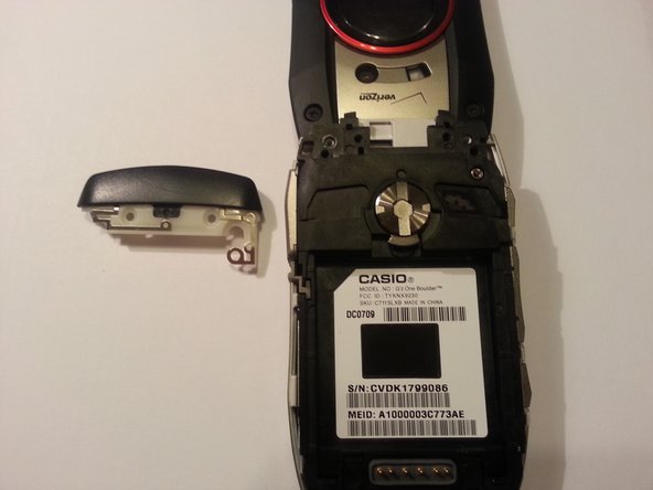

  5. G'z One Boulder New Antenna Replacement: crwdns2935265:05crwdnd2935265:01crwdnd2935265:02crwdne2935265:0 G'z One Boulder New Antenna Replacement: crwdns2935265:05crwdnd2935265:02crwdnd2935265:02crwdne2935265:0
    • With screw removed, gently pull the antenna outward. It should slide out easily.
