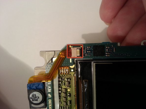

  6. G'z One Boulder Front Ear Speaker Replacement: crwdns2935265:06crwdnd2935265:01crwdnd2935265:03crwdne2935265:0 G'z One Boulder Front Ear Speaker Replacement: crwdns2935265:06crwdnd2935265:02crwdnd2935265:03crwdne2935265:0 G'z One Boulder Front Ear Speaker Replacement: crwdns2935265:06crwdnd2935265:03crwdnd2935265:03crwdne2935265:0
    • Pull the logic board out with a pry stick gently from bottom to top at the current orientation.
    • The ribbon cable will be connected underneath the logic board. A small amount of force is required to disconnect them.
    • Although some force is required to lift up the board, be careful as to not bend any of the pins on either side.
  7. G'z One Boulder Front Ear Speaker Replacement, Front Ear Speaker: crwdns2935265:07crwdnd2935265:01crwdnd2935265:02crwdne2935265:0 G'z One Boulder Front Ear Speaker Replacement, Front Ear Speaker: crwdns2935265:07crwdnd2935265:02crwdnd2935265:02crwdne2935265:0
    • Lift speaker towards yourself out of the white plastic container.
    • Gently unplug the ribbon by pulling it to the left with the pictured orientation in mind.
    • Be careful when unplugging connector as the ribbon connecting piece is extremely fragile.'
