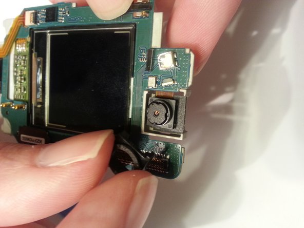

    1. G'z One Boulder Camera Replacement, Camera: crwdns2935265:07crwdnd2935265:01crwdnd2935265:02crwdne2935265:0 G'z One Boulder Camera Replacement, Camera: crwdns2935265:07crwdnd2935265:02crwdnd2935265:02crwdne2935265:0
      • There is a plastic square that surrounds the camera and keeps it in place. Pry this up first making note of the orientation of the part and how there is a tab pointing in the same direction as the ribbon cable.
      • Once it is loosened the surround can be removed and set aside. The next step is to detach the ribbon cable.

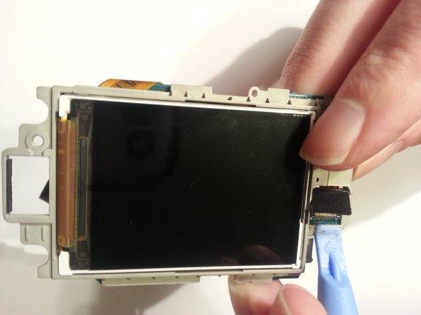

    2. G'z One Boulder Camera Replacement: crwdns2935265:08crwdnd2935265:01crwdnd2935265:02crwdne2935265:0 G'z One Boulder Camera Replacement: crwdns2935265:08crwdnd2935265:02crwdnd2935265:02crwdne2935265:0
      • Now turn the phone over so that you are looking at the inside LCD and the back of the camera.
      • Use a pry stick to disconnect the ribbon cable from the rest of the PCB board.
      • Gently feed the ribbon cable through the hole to completely remove the camera from the phone. The connector pulls straight through, do not bend or twist the ribbon cable.
