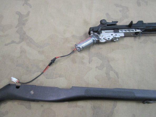

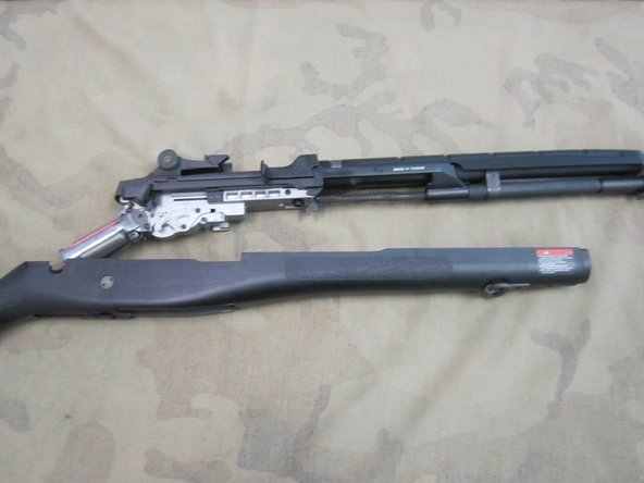

    • You can start removing the upper receiver from the body.
    • Just start pushing the receiver in a upward and forward direction as shown.
    • Make sure the wiring coming out does not get snagged on anything.

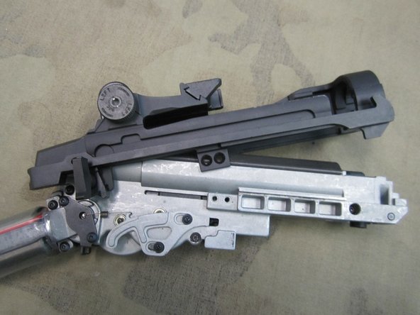

  4. G&G GR14 Airsoft Disassembly: crwdns2935265:04crwdnd2935265:01crwdnd2935265:03crwdne2935265:0 G&G GR14 Airsoft Disassembly: crwdns2935265:04crwdnd2935265:02crwdnd2935265:03crwdne2935265:0 G&G GR14 Airsoft Disassembly: crwdns2935265:04crwdnd2935265:03crwdnd2935265:03crwdne2935265:0

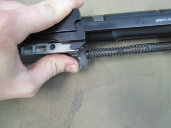

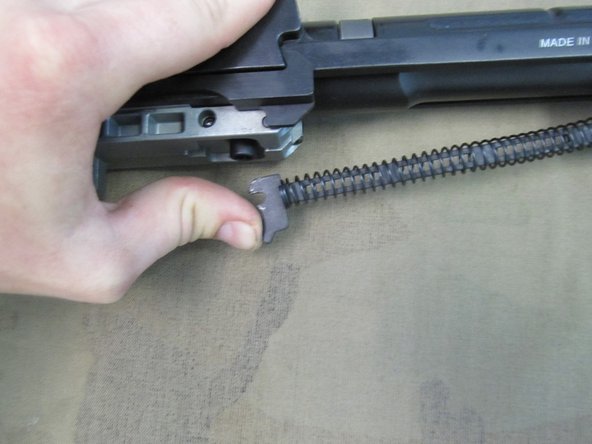

    • With the receiver completely out of the body you can begin separating the barrel from the rest of the receiver.
    • First remove the spring guide piece for the bolt pressing it forward and then pull it out.

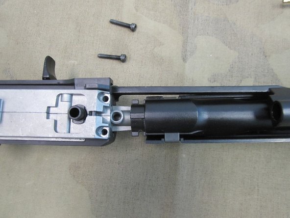

  5. G&G GR14 Airsoft Disassembly: crwdns2935265:05crwdnd2935265:01crwdnd2935265:02crwdne2935265:0 G&G GR14 Airsoft Disassembly: crwdns2935265:05crwdnd2935265:02crwdnd2935265:02crwdne2935265:0
    • Now remove the 2 large 3mm hex bolts.
    • With the bolts removed you can now pull off the front barrel assembly.

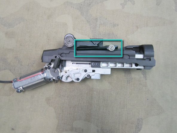

    • Now to return the focus to the main receiver section.
    • With the outer barrel off the charging handle should be easy to remove by pulling down from the top rear section as shown.
    • Now the fake bolt can be pulled forward and out of the receiver.

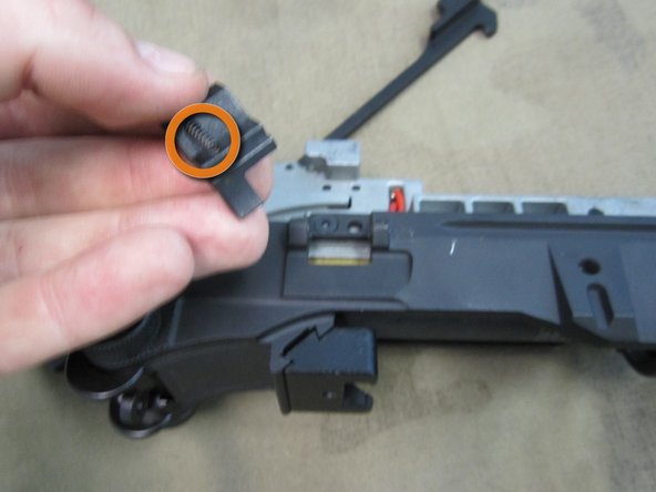

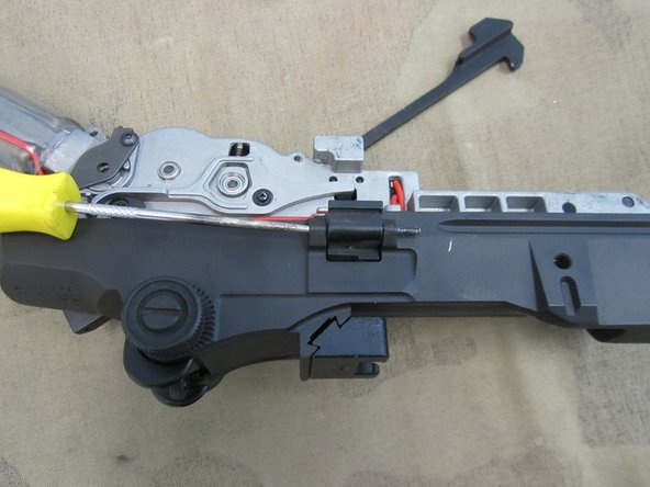

  8. G&G GR14 Airsoft Disassembly: crwdns2935265:08crwdnd2935265:01crwdnd2935265:03crwdne2935265:0 G&G GR14 Airsoft Disassembly: crwdns2935265:08crwdnd2935265:02crwdnd2935265:03crwdne2935265:0 G&G GR14 Airsoft Disassembly: crwdns2935265:08crwdnd2935265:03crwdnd2935265:03crwdne2935265:0

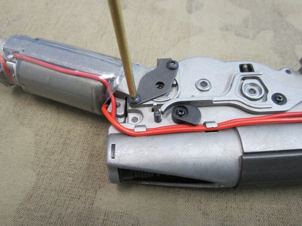

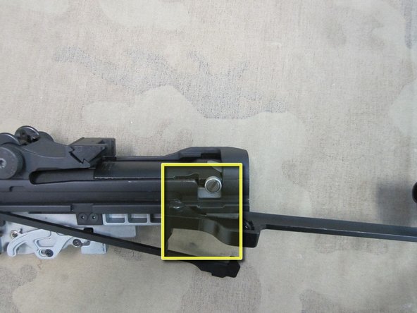

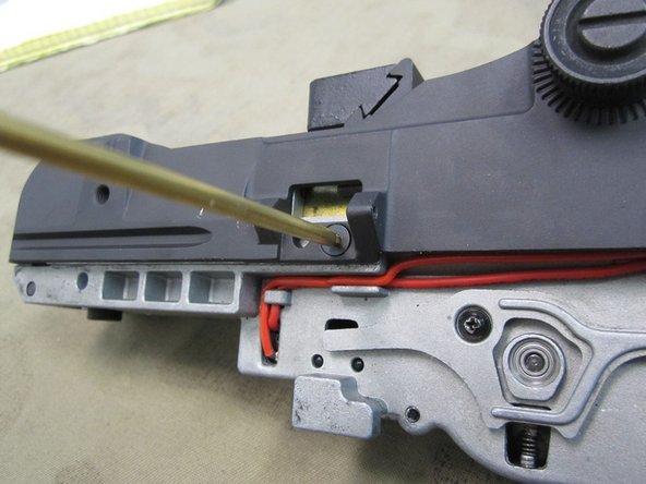

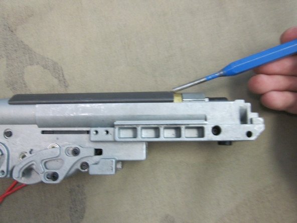

    • The next thing to do is remove the bolt catch. This will give you access to the small screw behind it which is part of the next step.
    • Punch out the the pin with either a thin punch or other appropriate tool. Once the pin is partially sticking out you can grab it with pliers.
    • Careful not to loose track of the spring behind the catch.

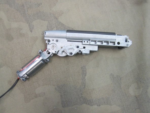

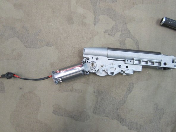

    • With the screws removed you can now separate the gearbox from the receiver.
    • Start by prying the front section off a little bit. Then slide the gearbox slightly forward and down.
    • You might have adjust the selector as you go if it is being stubborn.

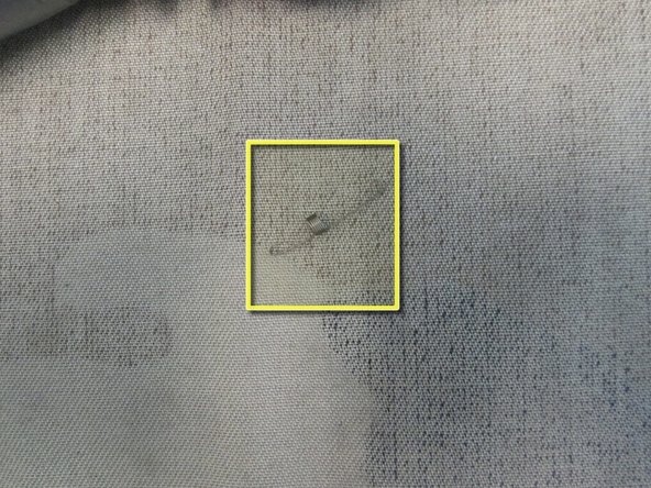

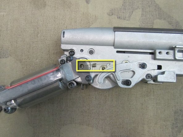

  11. G&G GR14 Airsoft Disassembly: crwdns2935265:011crwdnd2935265:01crwdnd2935265:03crwdne2935265:0 G&G GR14 Airsoft Disassembly: crwdns2935265:011crwdnd2935265:02crwdnd2935265:03crwdne2935265:0 G&G GR14 Airsoft Disassembly: crwdns2935265:011crwdnd2935265:03crwdnd2935265:03crwdne2935265:0
    • Now we break down the gearbox itself.
    • In this step all that is required is to remove the small spring with little hooks on both ends.
    • Once again this spring is also easy to loose, and as the center picture shows there also hard to see.

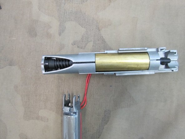

  13. G&G GR14 Airsoft Disassembly: crwdns2935265:013crwdnd2935265:01crwdnd2935265:02crwdne2935265:0 G&G GR14 Airsoft Disassembly: crwdns2935265:013crwdnd2935265:02crwdnd2935265:02crwdne2935265:0

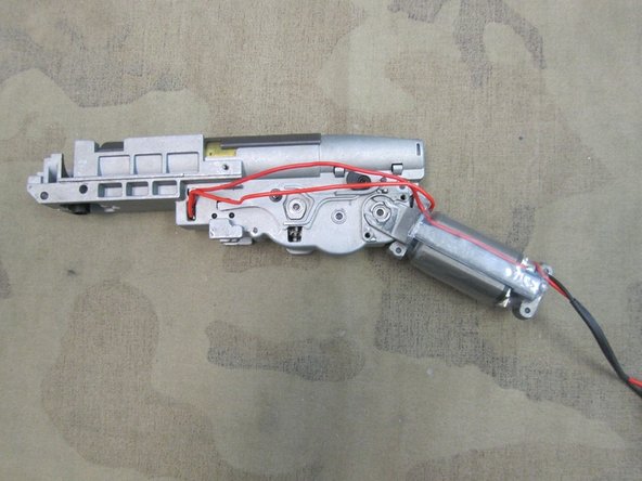

    • Now carefully take the wiring out of the of the brackets on the side of the gearbox.
    • Loosening the wiring allow you to put the motor in a better position to be removed.
  14. G&G GR14 Airsoft Disassembly: crwdns2935265:014crwdnd2935265:01crwdnd2935265:02crwdne2935265:0 G&G GR14 Airsoft Disassembly: crwdns2935265:014crwdnd2935265:02crwdnd2935265:02crwdne2935265:0
    • Now take the motor cage and turn it to the angle shown.
    • Then gently pull the motor cage off without damaging the wiring.
    • From this point the motor will be hanging around...

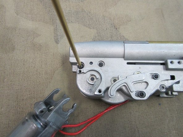

  15. G&G GR14 Airsoft Disassembly: crwdns2935265:015crwdnd2935265:01crwdnd2935265:02crwdne2935265:0 G&G GR14 Airsoft Disassembly: crwdns2935265:015crwdnd2935265:02crwdnd2935265:02crwdne2935265:0
    • Now remove the large pin that goes through the front of the gearbox.
    • Then remove the the large retainer strap at the top.

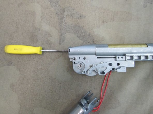

  17. G&G GR14 Airsoft Disassembly: crwdns2935265:017crwdnd2935265:01crwdnd2935265:03crwdne2935265:0 G&G GR14 Airsoft Disassembly: crwdns2935265:017crwdnd2935265:02crwdnd2935265:03crwdne2935265:0 G&G GR14 Airsoft Disassembly: crwdns2935265:017crwdnd2935265:03crwdnd2935265:03crwdne2935265:0
    • Now take a thin tool to go into the back hole to prevent the spring guide fromshooting out.
    • You can begin to the pry the two halves of the gearbox apart starting at the back .

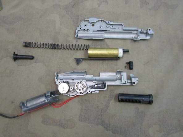

  18. G&G GR14 Airsoft Disassembly: crwdns2935265:018crwdnd2935265:01crwdnd2935265:03crwdne2935265:0 G&G GR14 Airsoft Disassembly: crwdns2935265:018crwdnd2935265:02crwdnd2935265:03crwdne2935265:0 G&G GR14 Airsoft Disassembly: crwdns2935265:018crwdnd2935265:03crwdnd2935265:03crwdne2935265:0
    • Once the gearbox is opened up quickly remove the main spring and spring guide so that nothing goes fly away.
    • After this point you can remove the gears. Just as in the other guide try not to misplace the shims unless you want to adjust the shimming yourself.

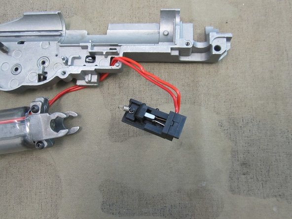

  19. G&G GR14 Airsoft Disassembly: crwdns2935265:019crwdnd2935265:01crwdnd2935265:02crwdne2935265:0 G&G GR14 Airsoft Disassembly: crwdns2935265:019crwdnd2935265:02crwdnd2935265:02crwdne2935265:0

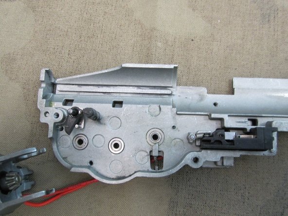

    • This step is going to cover some of the unique parts of the G&GM-14.
    • The first part people notice is the unique Anti-reversal latch. This piece can be pulled right out. The spring that is attached is almost identical to those found in version 2/3 gearboxes and functions in the same way.
    • Next part is the selector piece. This part interacts with the selector on the gun and will make your gun go full-auto or semi-auto depending on it's position. if you flip the gearbox over you can actually see how it directly interacts with the cut-off leaver.
    • It should be left alone but just encase it does need replacement there is a screw on the out side allowing it to be removed.
    • Lastly there is the trigger switch. This piece is pressed into place and once the spring is detached from the gearbox post, the switch can be pulled out as shown.
