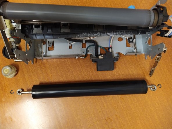

    • A damaged pressure roller leads to paper jamming as the front edge reaches the fuser.
    • New rollers have a smooth surface. The crinkled surface just visible in the attached picture was associated with paper jams every 20 pages.

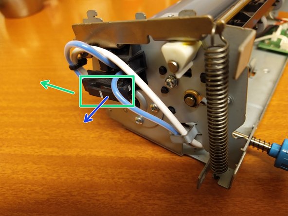

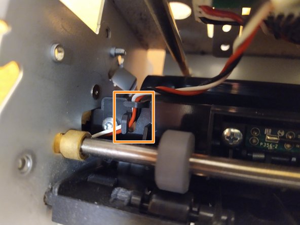

  3. Fuser pressure roller replacement for Lexmark MS710 series printer, unclip the wires: crwdns2935265:03crwdnd2935265:01crwdnd2935265:03crwdne2935265:0 Fuser pressure roller replacement for Lexmark MS710 series printer, unclip the wires: crwdns2935265:03crwdnd2935265:02crwdnd2935265:03crwdne2935265:0 Fuser pressure roller replacement for Lexmark MS710 series printer, unclip the wires: crwdns2935265:03crwdnd2935265:03crwdnd2935265:03crwdne2935265:0
    • Unplug this wire and unthread it from the hooks so that it is free to move and provide the slack that will be needed to move the fuser sleeve.
    • Slide this clip off to provide some slack in the cables at the other end of the fuser sleeve.
    • The front of the clip pulls slightly outwards to release the clip for sliding off.

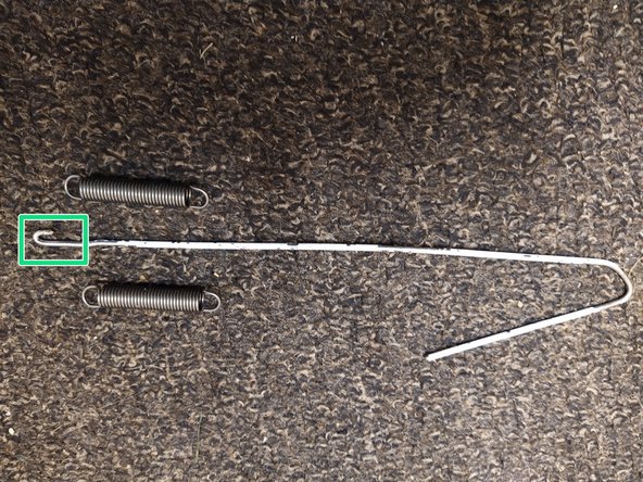

    • The strong spring at each end of the fuser needs to be removed to release the pressure on the rollers.
    • A strong hook is needed to unhook the spring. The example in the picture is made from a wire coat hanger.

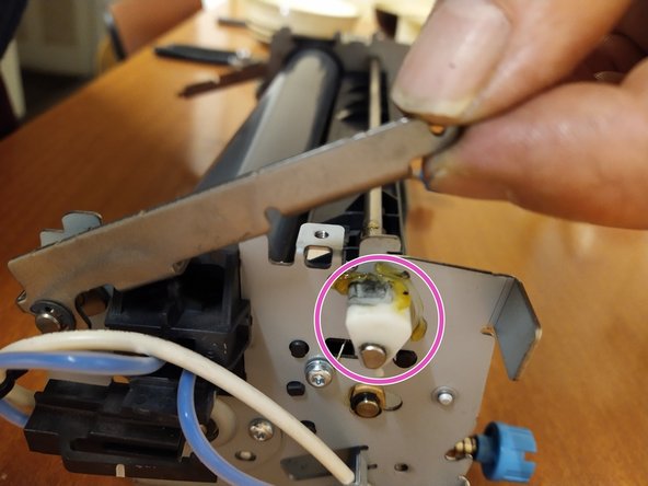

    • The lever at each end of the fuser can now be lifted, clearing the way to release the rollers.
    • Note how the plastic wedge is in a vertical position. The wedge must be set to this vertical position on re-assembly.
    • This wedge lifts the lever, reducing the pressure on the rollers which would otherwise create flat areas on the soft pressure roller. The printer moves this wedge to increase the pressure only when the rollers are rotating ready to print.

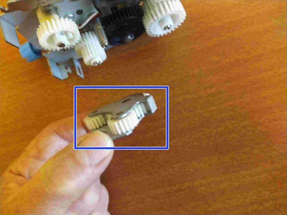

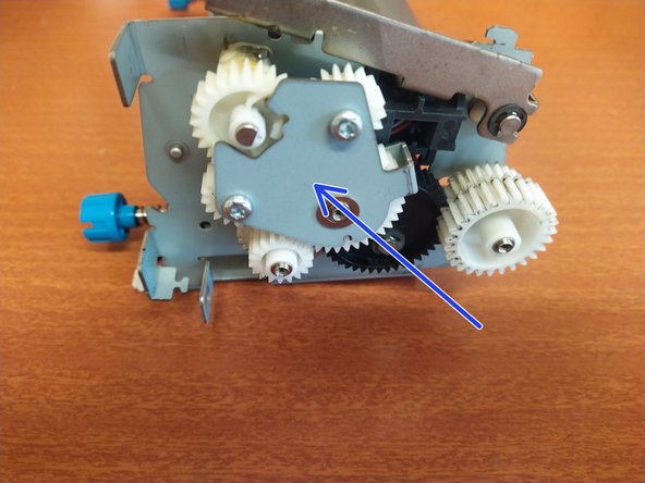

  6. Fuser pressure roller replacement for Lexmark MS710 series printer, Remove some cogwheels: crwdns2935265:06crwdnd2935265:01crwdnd2935265:03crwdne2935265:0 Fuser pressure roller replacement for Lexmark MS710 series printer, Remove some cogwheels: crwdns2935265:06crwdnd2935265:02crwdnd2935265:03crwdne2935265:0 Fuser pressure roller replacement for Lexmark MS710 series printer, Remove some cogwheels: crwdns2935265:06crwdnd2935265:03crwdnd2935265:03crwdne2935265:0
    • Remove the three 5mm Torx T10 screws and remove the metal plate covering the cog wheels.
    • Remove the block of three cogwheels to allow access to the black drive pulley.

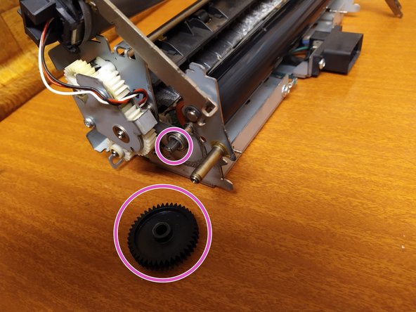

  7. Fuser pressure roller replacement for Lexmark MS710 series printer, Remove the drive cog: crwdns2935265:07crwdnd2935265:01crwdnd2935265:02crwdne2935265:0 Fuser pressure roller replacement for Lexmark MS710 series printer, Remove the drive cog: crwdns2935265:07crwdnd2935265:02crwdnd2935265:02crwdne2935265:0
    • Remove the circlip retaining the fuser drive cog. A small flat bladed screwdriver can be used to remove the circlip.
    • The large black cogwheel can now be removed from the end of the fuser pressure roller.

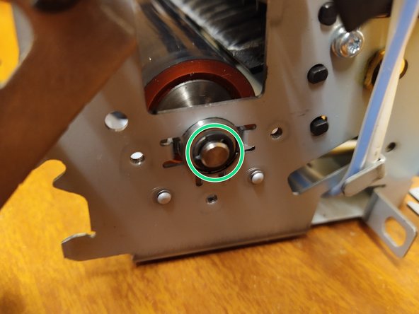

  8. Fuser pressure roller replacement for Lexmark MS710 series printer, Release the second end bearing: crwdns2935265:08crwdnd2935265:01crwdnd2935265:02crwdne2935265:0 Fuser pressure roller replacement for Lexmark MS710 series printer, Release the second end bearing: crwdns2935265:08crwdnd2935265:02crwdnd2935265:02crwdne2935265:0
    • Remove the three 5mm Torx T10 screws and remove the plate covering the bearing.
    • Remove the circlip retaining this end of the pressure roller.
  9. Fuser pressure roller replacement for Lexmark MS710 series printer, Remove the fuser film sleeve: crwdns2935265:09crwdnd2935265:01crwdnd2935265:01crwdne2935265:0
    • The fuser film sleeve can now be removed from above the pressure roller and left to rest on top of the fuser. It is not necessary to disconnect the fuser heater if only the pressure roller is being replaced.
    • In the pictures, this roller was moved earlier in the sequence. But it is better to leave this fragile component in place for as long as possible.
  10. Fuser pressure roller replacement for Lexmark MS710 series printer, Remove the pressure roller: crwdns2935265:010crwdnd2935265:01crwdnd2935265:02crwdne2935265:0 Fuser pressure roller replacement for Lexmark MS710 series printer, Remove the pressure roller: crwdns2935265:010crwdnd2935265:02crwdnd2935265:02crwdne2935265:0
    • There pressure roller axle now has the freedom to slide to the left.
    • This releases the right hand end of the axle from its mounting so that the pressure roller can be lifted upwards and removed.
