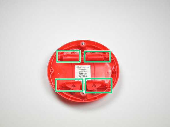

    • Locate all four of the foot activation levers. Remove them one by one from the base.

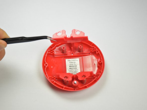

    • Locate the feet pieces and remove them.

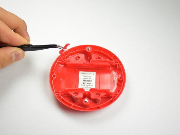

    • Locate and gently lift out the four small springs using tweezers.
    • Now that you have all parts are removed, they can be cleaned and reassembled into Furby's "feet".
