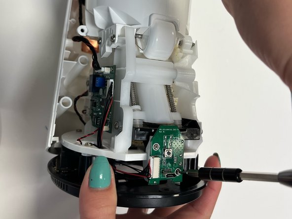

    • Once you have separated the two plastic coverings, remove one side by pulling on it and carefully separating it from the adhesive.
  6. Furbo Dog Camera USB Power Jack Replacement, USB Power Jack: crwdns2935265:06crwdnd2935265:01crwdnd2935265:02crwdne2935265:0 Furbo Dog Camera USB Power Jack Replacement, USB Power Jack: crwdns2935265:06crwdnd2935265:02crwdnd2935265:02crwdne2935265:0
    • Use a Phillips #000 screwdriver to remove the two 5 mm screws from the USB power jack.

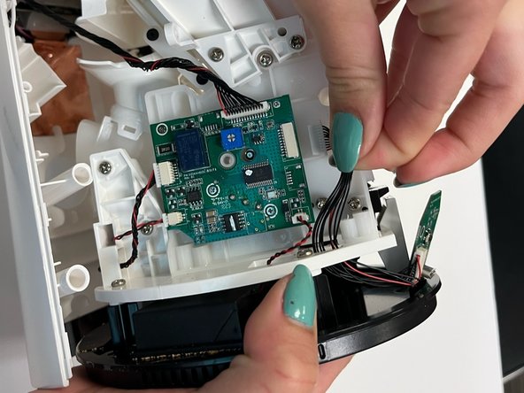

  7. Furbo Dog Camera USB Power Jack Replacement: crwdns2935265:07crwdnd2935265:01crwdnd2935265:02crwdne2935265:0 Furbo Dog Camera USB Power Jack Replacement: crwdns2935265:07crwdnd2935265:02crwdnd2935265:02crwdne2935265:0
    • Once you have removed the screws, gently pull the bundled cable connector free from the motherboard.

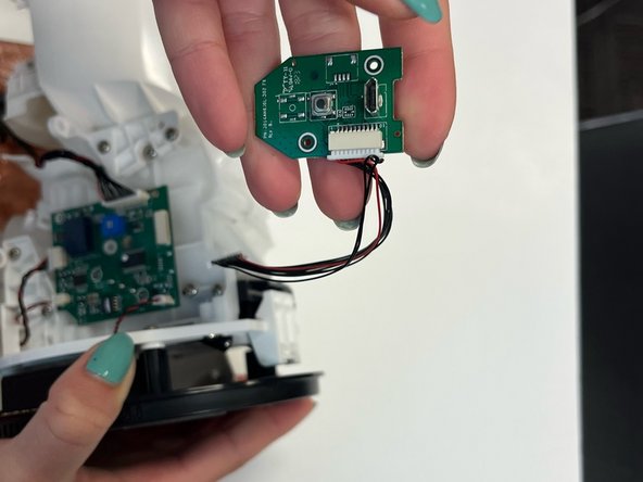

  8. Furbo Dog Camera USB Power Jack Replacement: crwdns2935265:08crwdnd2935265:01crwdnd2935265:03crwdne2935265:0 Furbo Dog Camera USB Power Jack Replacement: crwdns2935265:08crwdnd2935265:02crwdnd2935265:03crwdne2935265:0 Furbo Dog Camera USB Power Jack Replacement: crwdns2935265:08crwdnd2935265:03crwdnd2935265:03crwdne2935265:0
    • The USB power jack PCB can now be removed from your Furbo and replaced.
