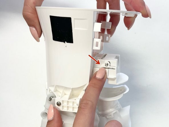

    • Use a Phillips #000 screwdriver to remove the two small 3 mm black screws on either side of the plastic hinge.
    • After removing the two screws, carefully pull off the plastic hinge.
  7. Furbo Dog Camera Treat Guide Chamber Replacement: crwdns2935265:07crwdnd2935265:01crwdnd2935265:03crwdne2935265:0 Furbo Dog Camera Treat Guide Chamber Replacement: crwdns2935265:07crwdnd2935265:02crwdnd2935265:03crwdne2935265:0 Furbo Dog Camera Treat Guide Chamber Replacement: crwdns2935265:07crwdnd2935265:03crwdnd2935265:03crwdne2935265:0
    • Locate each end of the treat chamber door where the white plastic hook is latched behind the metal rod, and carefully unlatch the entire white plastic piece from the metal rod on both sides.

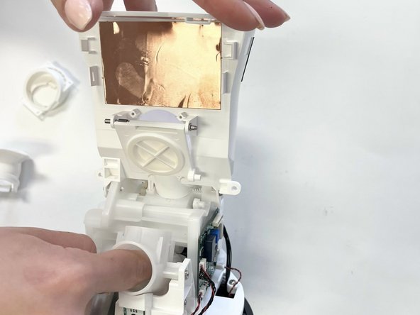

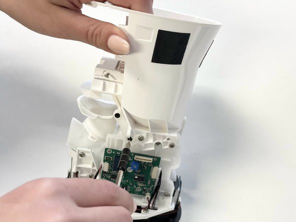

    • Use a Phillips #000 screwdriver to remove the two 5 mm screws above the treat dispensing door.
  9. Furbo Dog Camera Treat Guide Chamber Replacement: crwdns2935265:09crwdnd2935265:01crwdnd2935265:03crwdne2935265:0 Furbo Dog Camera Treat Guide Chamber Replacement: crwdns2935265:09crwdnd2935265:02crwdnd2935265:03crwdne2935265:0 Furbo Dog Camera Treat Guide Chamber Replacement: crwdns2935265:09crwdnd2935265:03crwdnd2935265:03crwdne2935265:0
    • Lift up the treat dispensing door, and use a Phillips #000 screwdriver to remove the two 5 mm screws at the bottom of the dispensing hole.

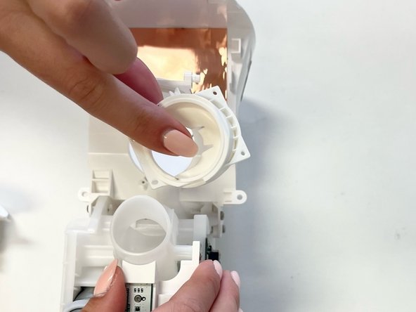

    • Carefully pull off the treat dispensing chamber with your hands and set it aside.
    • the treat dispensing chamber is the curved white plastic tube below the treat dispensing door.

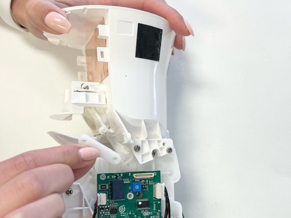

  11. Furbo Dog Camera Treat Guide Chamber Replacement: crwdns2935265:011crwdnd2935265:01crwdnd2935265:03crwdne2935265:0 Furbo Dog Camera Treat Guide Chamber Replacement: crwdns2935265:011crwdnd2935265:02crwdnd2935265:03crwdne2935265:0 Furbo Dog Camera Treat Guide Chamber Replacement: crwdns2935265:011crwdnd2935265:03crwdnd2935265:03crwdne2935265:0
    • Lift the treat chamber door, and carefully pull the treat guide chamber free.
    • This is the circular plastic piece that rests behind the treat dispensing door.
  12. Furbo Dog Camera Treat Guide Chamber Replacement: crwdns2935265:012crwdnd2935265:01crwdnd2935265:02crwdne2935265:0 Furbo Dog Camera Treat Guide Chamber Replacement: crwdns2935265:012crwdnd2935265:02crwdnd2935265:02crwdne2935265:0
    • Now that both your treat guide chamber and treat dispensing chamber have been removed, you can stick your finger into the launching mechanism to dislodge any jammed treats.
