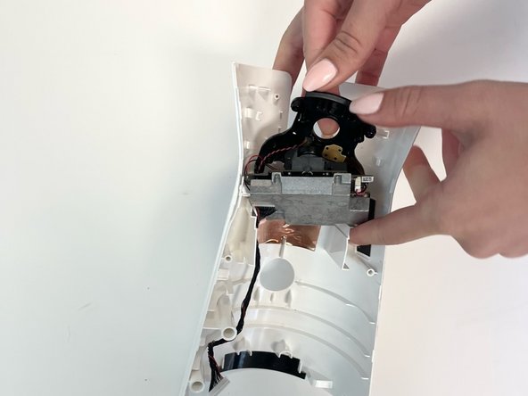

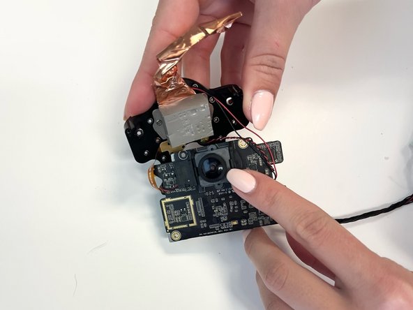

  6. Furbo Dog Camera Barking Sensor Assembly Replacement, Camera Lens: crwdns2935265:06crwdnd2935265:01crwdnd2935265:03crwdne2935265:0 Furbo Dog Camera Barking Sensor Assembly Replacement, Camera Lens: crwdns2935265:06crwdnd2935265:02crwdnd2935265:03crwdne2935265:0 Furbo Dog Camera Barking Sensor Assembly Replacement, Camera Lens: crwdns2935265:06crwdnd2935265:03crwdnd2935265:03crwdne2935265:0
    • Carefully remove the copper foiling that surrounds the camera hardware.

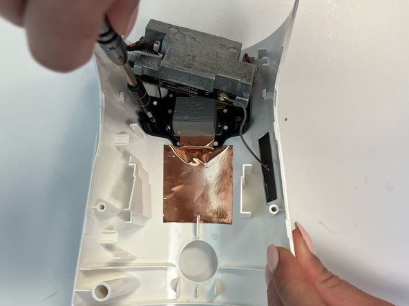

  7. Furbo Dog Camera Barking Sensor Assembly Replacement: crwdns2935265:07crwdnd2935265:01crwdnd2935265:02crwdne2935265:0 Furbo Dog Camera Barking Sensor Assembly Replacement: crwdns2935265:07crwdnd2935265:02crwdnd2935265:02crwdne2935265:0
    • Use a Phillips #000 screwdriver to remove the 2.5 mm screws at the top of the camera hardware.

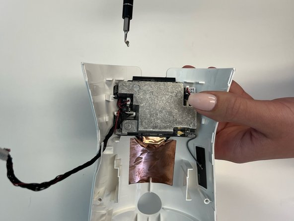

  8. Furbo Dog Camera Barking Sensor Assembly Replacement: crwdns2935265:08crwdnd2935265:01crwdnd2935265:02crwdne2935265:0 Furbo Dog Camera Barking Sensor Assembly Replacement: crwdns2935265:08crwdnd2935265:02crwdnd2935265:02crwdne2935265:0
    • Gently pry the metal backing off of the camera hardware.
  9. Furbo Dog Camera Barking Sensor Assembly Replacement: crwdns2935265:09crwdnd2935265:01crwdnd2935265:02crwdne2935265:0 Furbo Dog Camera Barking Sensor Assembly Replacement: crwdns2935265:09crwdnd2935265:02crwdnd2935265:02crwdne2935265:0
    • Use a Phillips #000 screwdriver to remove the 0.4 mm screws that attach the camera to the Furbo case.

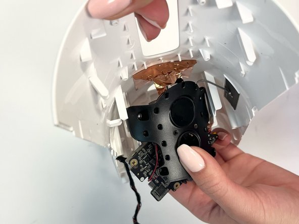

  10. Furbo Dog Camera Barking Sensor Assembly Replacement: crwdns2935265:010crwdnd2935265:01crwdnd2935265:03crwdne2935265:0 Furbo Dog Camera Barking Sensor Assembly Replacement: crwdns2935265:010crwdnd2935265:02crwdnd2935265:03crwdne2935265:0 Furbo Dog Camera Barking Sensor Assembly Replacement: crwdns2935265:010crwdnd2935265:03crwdnd2935265:03crwdne2935265:0
    • Gently pry the camera off and detach it from the Furbo.

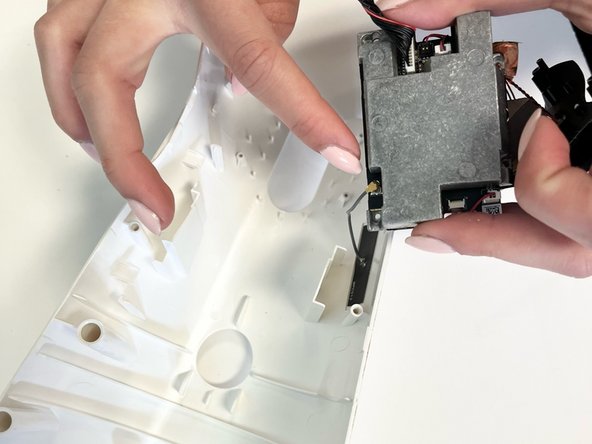

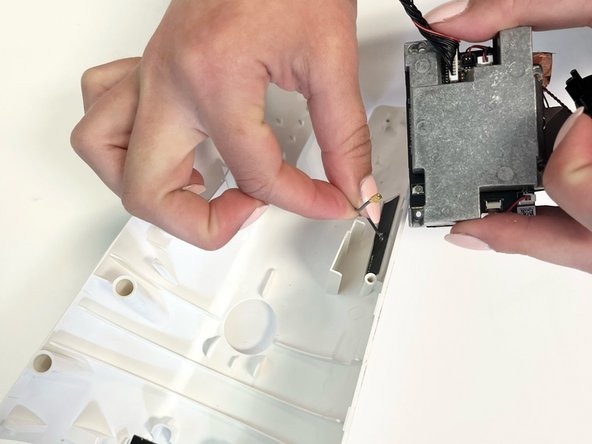

  11. Furbo Dog Camera Barking Sensor Assembly Replacement: crwdns2935265:011crwdnd2935265:01crwdnd2935265:03crwdne2935265:0 Furbo Dog Camera Barking Sensor Assembly Replacement: crwdns2935265:011crwdnd2935265:02crwdnd2935265:03crwdne2935265:0 Furbo Dog Camera Barking Sensor Assembly Replacement: crwdns2935265:011crwdnd2935265:03crwdnd2935265:03crwdne2935265:0
    • Detach the wire attaching the camera hardware from the Furbo.
  12. Furbo Dog Camera Barking Sensor Assembly Replacement: crwdns2935265:012crwdnd2935265:01crwdnd2935265:02crwdne2935265:0 Furbo Dog Camera Barking Sensor Assembly Replacement: crwdns2935265:012crwdnd2935265:02crwdnd2935265:02crwdne2935265:0
    • Once removed, you may replace your camera.
